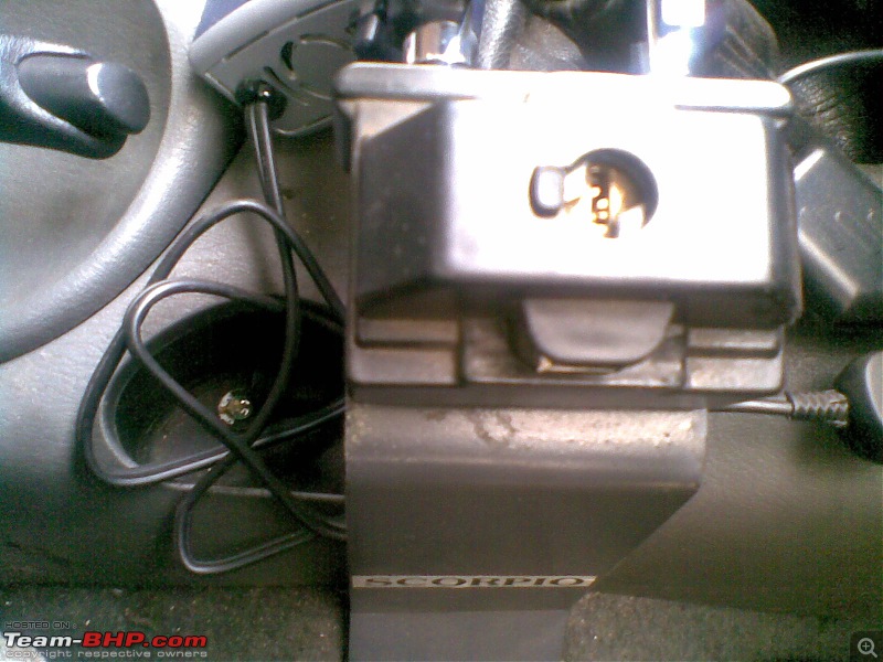

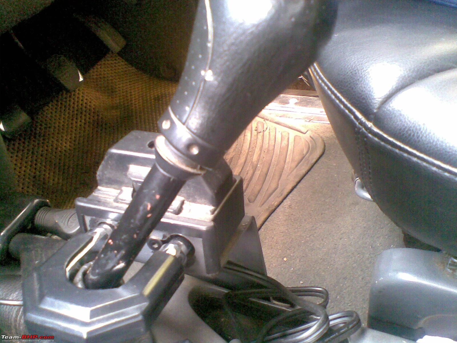

Thanks HVK, will check with Autocop or Minda. I guess this is the U type gear lock? I saw one photograph on the Scorpio owner's thread. BTW, will the fitting have to be done at the workshop or at the accessory shop?
kaushik_s is offline
Old 7th April 2011, 13:04   #2004
hvkumar's Avatar
Posts: 7,369
Thanked: 3,463 Times
Re: Mahindra Scorpio : Issues & Solutions
Yes, it is U-type.
The lock guys will come to your location and fix it, you don't have to go anywhere. Comes with spare keys and warranties.

Thanks a lot HVK for the photographs. The same kind of gear lock is there in my uncle's Bolero too. I'll get it fixed asap in my Scorpio too.
