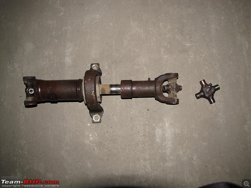

Hai Scorpio lovers,
My 2x4 2007 July CRDe truck, WOLT has done 62 K kms, I've driven rough terrain many times including Ladakh and HP. The noises and vibrations from the drive shaft resulted in a check in the pit, the Universal Joints (UJ's) were gone. Got it replaced at the ASC, Ahmedabad, Cost:
Universal Kit joints - 2633
Front Shaft Tubes - 4090
Bearing replacement charges - 850
Taxes - 1096
Total - 8669/-
When they opened up, the front shaft tubes (its a whole housing on which the shafts rotate, a heavy piece)were found to be worn out and squeaking, specially the bearings, I decided to change it. Water must have entered the housing during the many hill drives / water crossings and water logged rainy drives; the ASC guys say this usually lasts longer, they are surprised mine has gone in 62!!! If the shaft tubes are not changed they can again damage the UJ's because of the vibration it can cause and the whole exercise may have to be repeated in about 20-30 K kms. Uploading a couple of pictrues of the same.
Mahindra Scorpio : Issues & Solutions-uj1.jpg
Mahindra Scorpio : Issues & Solutions-uj2.jpg
Mahindra Scorpio : Issues & Solutions-uj3.jpg
Mahindra Scorpio : Issues & Solutions-uj4.jpg
Note the rad arrow points the shaft bearings which was vibrating requiring change of the whole piece.
Mahindra Scorpio : Issues & Solutions-uj4a.jpg
My questions to users / experts here:
1) Many might have changed the UJ's; at what Km did you change it?
2) How many of you have changed Front Shaft Tubes? At what KM?
3) Is greasing of the UJ's needed? I know many people do. The ASC guys are emphatic, NO GREASING is needed? Why are they not advocating not to grease the joints? I asked the, they said they never do, not required etc.,
Found that the MHwak does not need greasing, M&M has eliminated it, wonder how?
What about non-Mhwak Scorpios? Confused on the greasing issue, views and comments please.
Thanks.
--Ramky
Thanks.
--Ramky
If the Universal Joints are sealed type with life time grease, then they generally do not need external greasing. My experience is base on 25 year old experience with Ambassadors and Fiats. All joints having nipples were greased religiously every service. With a lot of front wheel drive vehicles to day, there is no need to grease, hence most shops do not even have a grease gun.
Please check the type of joints you have, if there is a nipple, you have to grease it, if none you do not. But, a big but, if you immerse the joints in water, it is better to grease them ASAP, as water would not only leach away grease, it can introduce fine dirt that would erode you joint really fast.
If you regularly traverse bad/no roads, check all the seals for wear regularly, and replace them ASAP.
Aroy is offline

Re: Mahindra Scorpio : Issues & Solutions
Aroy,
Thanks for that input.
I know for a fact the Front wheel drive ones do not need greasing, from extensive experience with Matutis, Hundai and Ford. Long back had an Amby and Fiat too.
Now, my drive shaft gear box end does have a nipple, so as per your theory, it needs greasing. That's my reading too. The ASC grease monkeys were emphatic, NO GREASING, so the confusion.
Would love to hear from other Scorp owners. Thanks.
--Ramky
...my drive shaft gear box end does have a nipple, so as per your theory, it needs greasing. That's my reading too. The ASC grease monkeys were emphatic, NO GREASING, so the confusion.
All the U-joints on a Scorpio have grease nipples (both driveshafts on a 4WD - a total of 4 grease nipples). And U-joints MUST be greased (unlike CV joints which have a rubber boot to keep out the dust and keep in the grease) - the interval may vary from car to car, but 30k - 50k km is usual. My ASC (Koncept, Okhla) finally did grease the U-joints at my 30k km service (they finally got greasing equipment, after a battle of words earlier ), but it wasn't EP (extreme pressure) grade grease.
Bought another grease gun finally (lost the old one), and intend to get under the car sometime soon.
SS-Traveller is offline

Yes, the Universal Joint is otherwise referred to as the STAR Joint - on account of the way it looks when dismantled.
This is the main transmission linkage from engine, gearbox down, through the differential and thence, to the axles in a Rear Wheel Drive vehicle.
With age and a certain amount of rough-ish usage, the joint tends to weaken and makes a "gadink-gadink" sort of noise, noticeable while changing gears, especially while down-shifting - say from 4th to 3rd and 3rd to 2nd. Used to be a common thing in the old Ambys.
If this situation arises, ideally the joint should to be replaced. But many of our local mechanics are able to give a new lease of life to these parts by administering a little judicious lathe work to them.
It happened in my Bolero after 3 years/ 30,000 kms so I had the whole assembly replaced completely at the cost of about 8500 bucks in 2008 and then sold it on to the next chap so that he wouldn't discover later that he had an expensive job on his hands. But I made sure I charged the bloke a rate for my Bolero according to the condition it was in and the care and affection that I had invested in it. The service history was there for him to see. That Bolero's OEM Battery died after it had completed 2.5 years and about 25000 kms so I had replaced that as well.
Now so far my Scorpio has clocked 36k + in various kinds of usage and various types of road conditions and there are no funny and expensive sounding noises yet - thankfully. And so far the battery which is the OEM one, is showing up well in its regular tests. Hope the good fortune continues!
