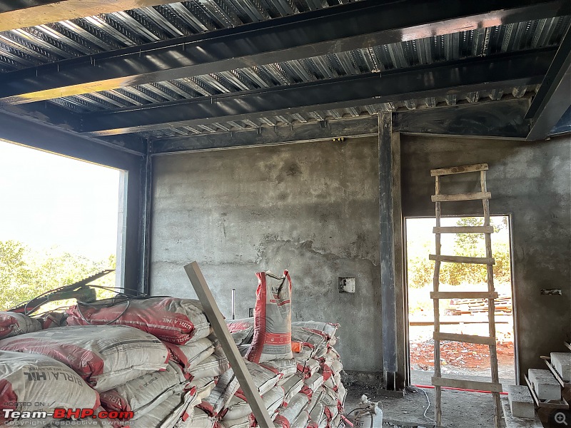

Update:
First floor walls are almost complete. Both interior and exterior walls are aerated concrete blocks of 6 inches. On the ground floor electric piping along the wall is complete rest is along the floor. All window and door granite framing is complete. The Concealed copper piping for Air conditions and relative plumbing for the ground floor is complete. The ground floor interior is ready for plaster work.
I am using Birla premixed plaster bags of 40 kgs each. Little expensive compared to conventional mixing of sand and cement but it has fibers (to prevent cracks) and waterproofing agents mixed in the bag itself. This also helps in quality control and consistent strength through out.
The Ac's on the ground floor are 2 Cassette, 2 ton each for the living area and 1.5 ton split for the bedroom.
Hopefully by the time Ground floor plaster begins in a couple of days, the first floor will be ready for electric/AC and plumbing work so that I can move that team from ground to first without a gap in work.
Some pictures
Exterior and Interior walls

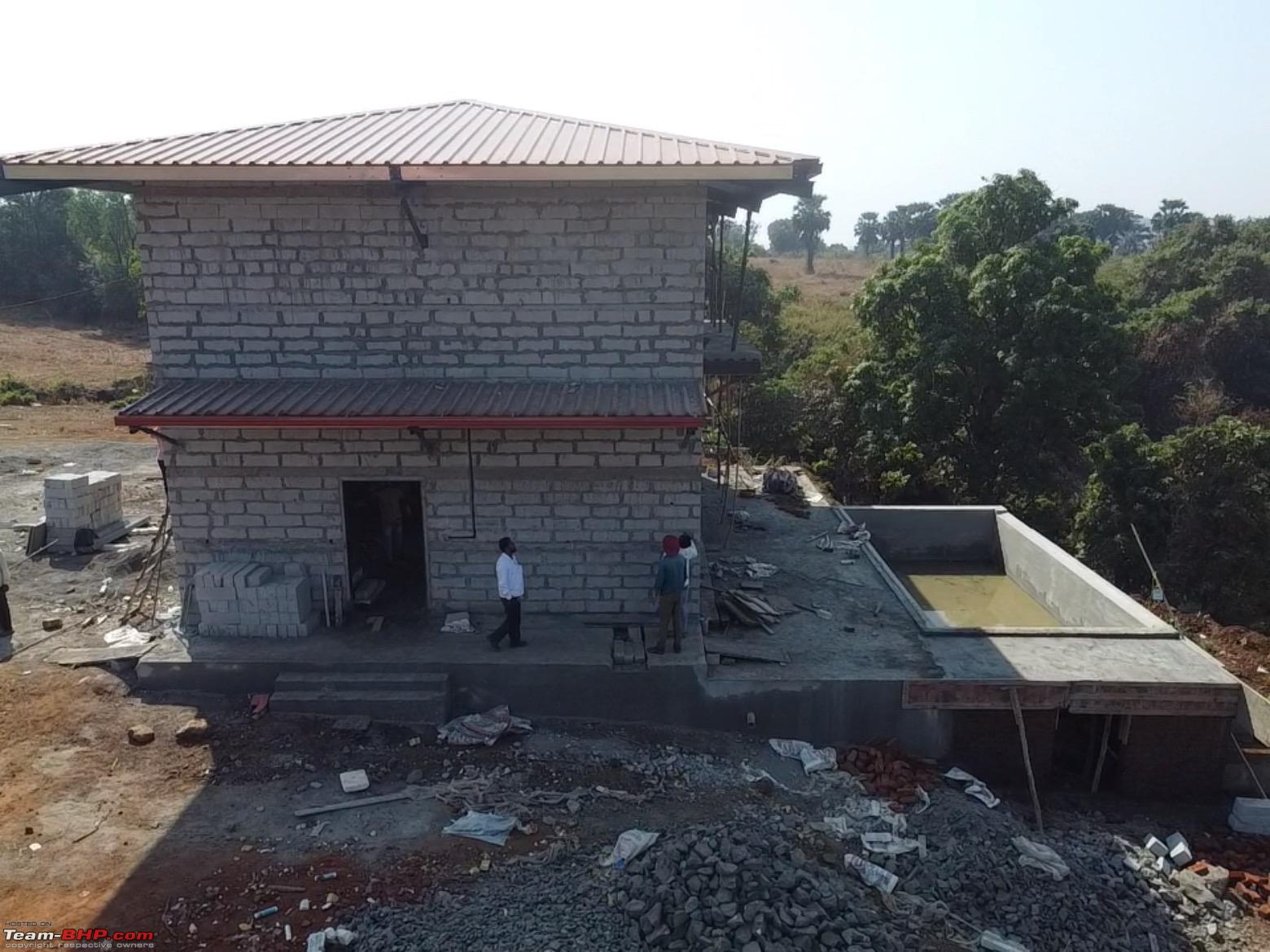

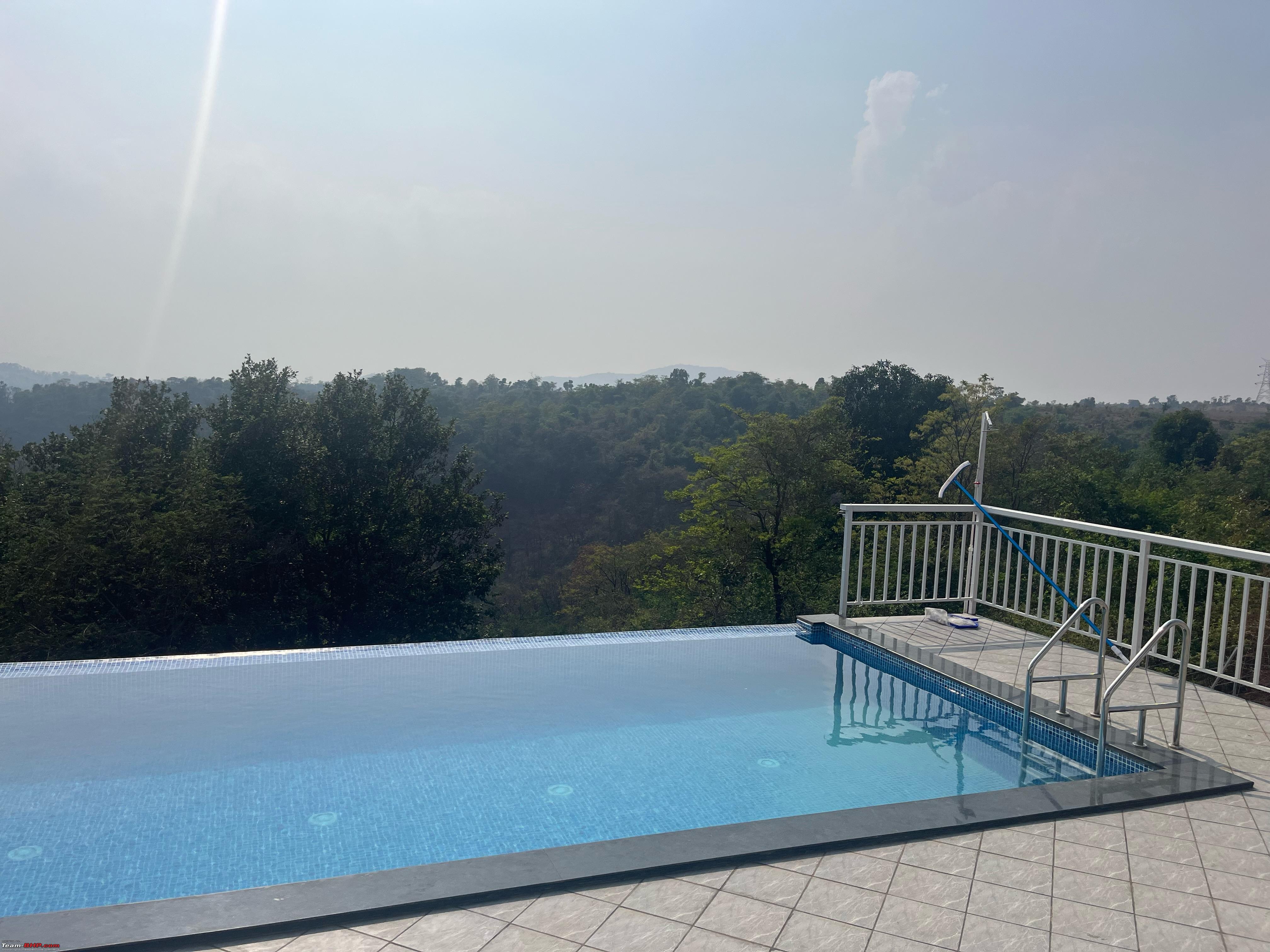

Finished Civil work of the infinity pool

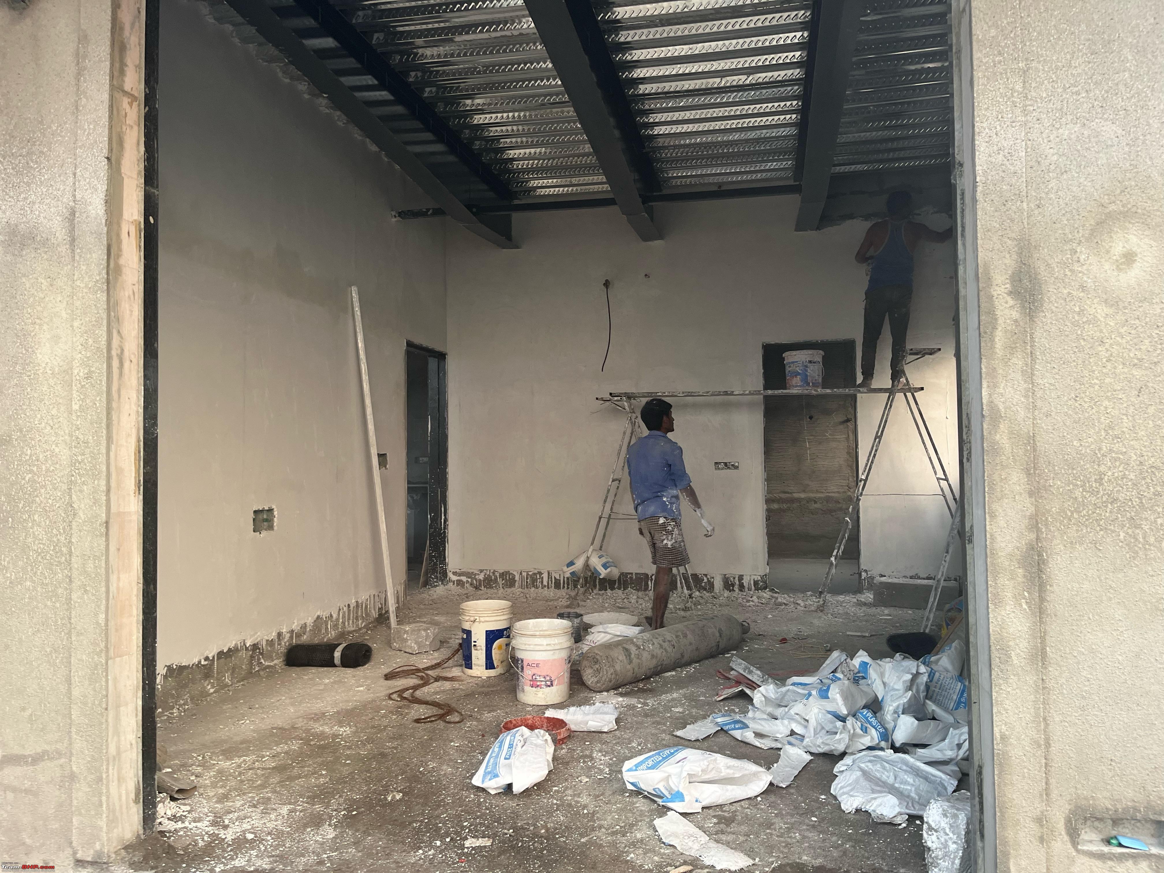

Latest update:
It has been exactly 3 months since work started. The internal plaster for both ground floor and first floor is complete. Waterproofing for all washrooms is finished and plumbing for ground floor washrooms and kitchen is done. The pump room for the swimming pool is finished and decided to extend the patio over the pump room.
The external plaster has started and the south side wall is completed. All granite door and window frame is compete. We have finalized the tiles for the entire house except the outside Patio, hopefully tiling work will start by the end of this week.
Some pictures:
Internal wall plaster
Constructing a new farmhouse | Complete greenfield project-internal-plaster-1.jpg
Constructing a new farmhouse | Complete greenfield project-internal-plaster-2.jpg
Constructing a new farmhouse | Complete greenfield project-internal-plaster-1st-floor.jpg

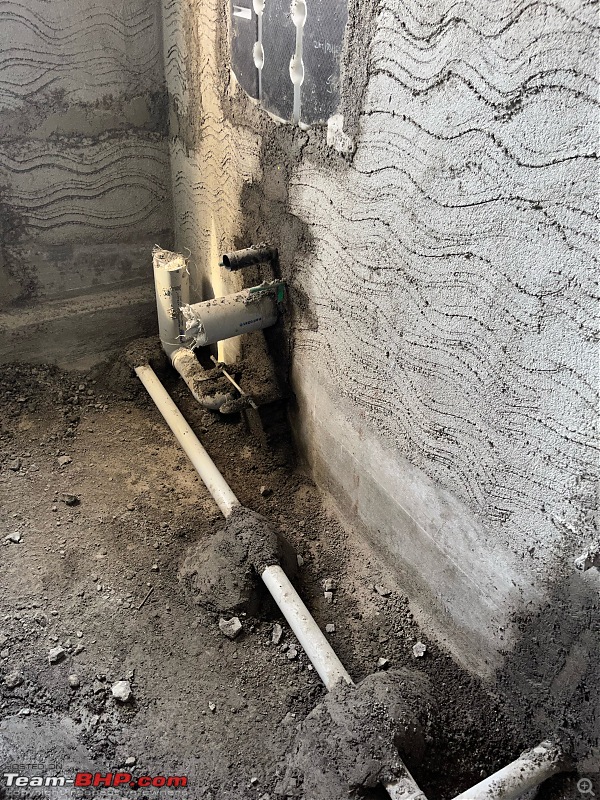

Washroom plumbing and waterproofing
Constructing a new farmhouse | Complete greenfield project-bathroom-plumbing-1.jpg
Constructing a new farmhouse | Complete greenfield project-bathroom-plumbing-2.jpg

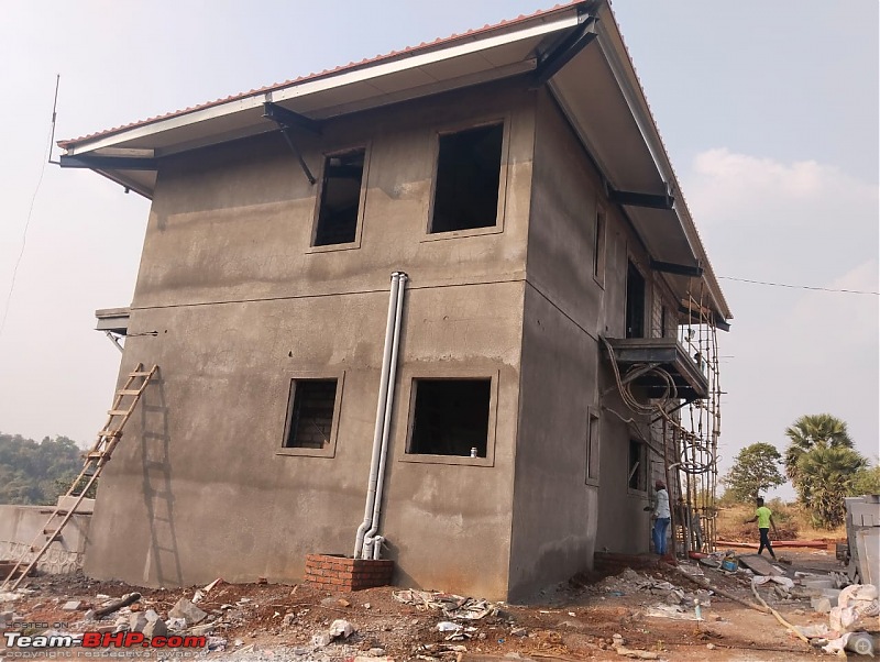

External plaster
Constructing a new farmhouse | Complete greenfield project-external-plaster.jpg
Constructing a new farmhouse | Complete greenfield project-extrenal-plaster-2.jpg

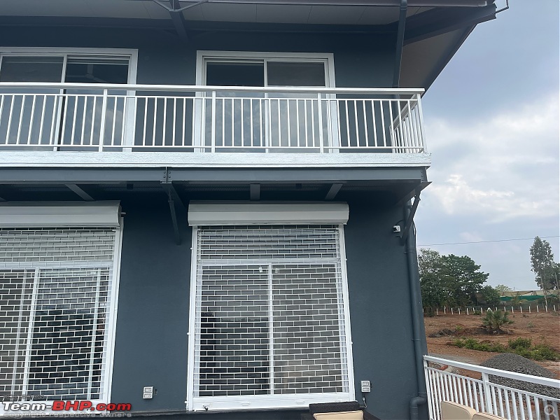

Update:
All the civil/structure work is complete.
Wash room plumbing is complete and the tile work has started.
Preparation for wall painting has started (Plaster of paris).
Safety rail for first floor balconies is installed.

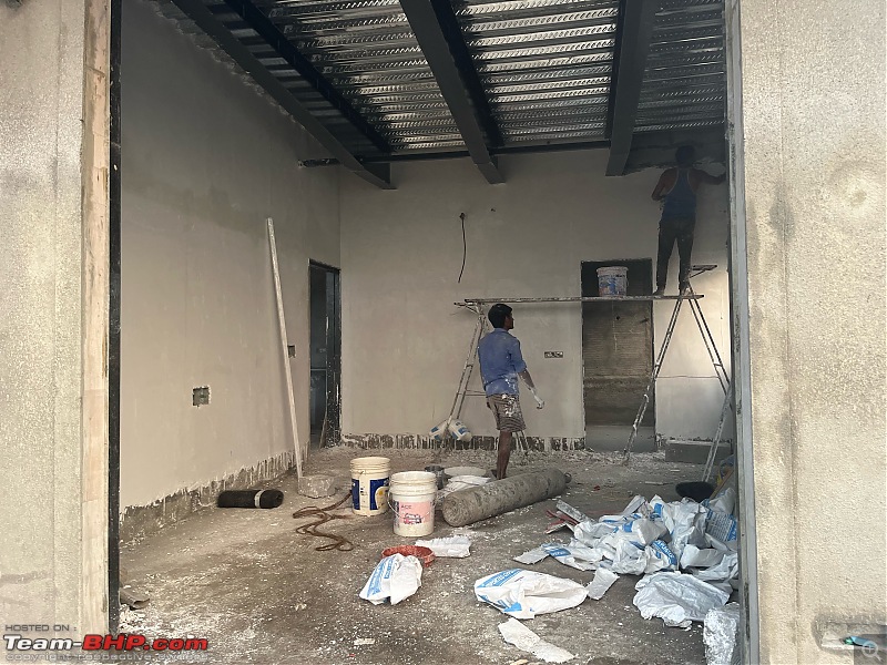

Wall preparation for painting
Constructing a new farmhouse | Complete greenfield project-29e0e2883cff4dbdae628c087f77dace.jpeg
Constructing a new farmhouse | Complete greenfield project-c8649715e6324870b12f15e1501e387d.jpeg

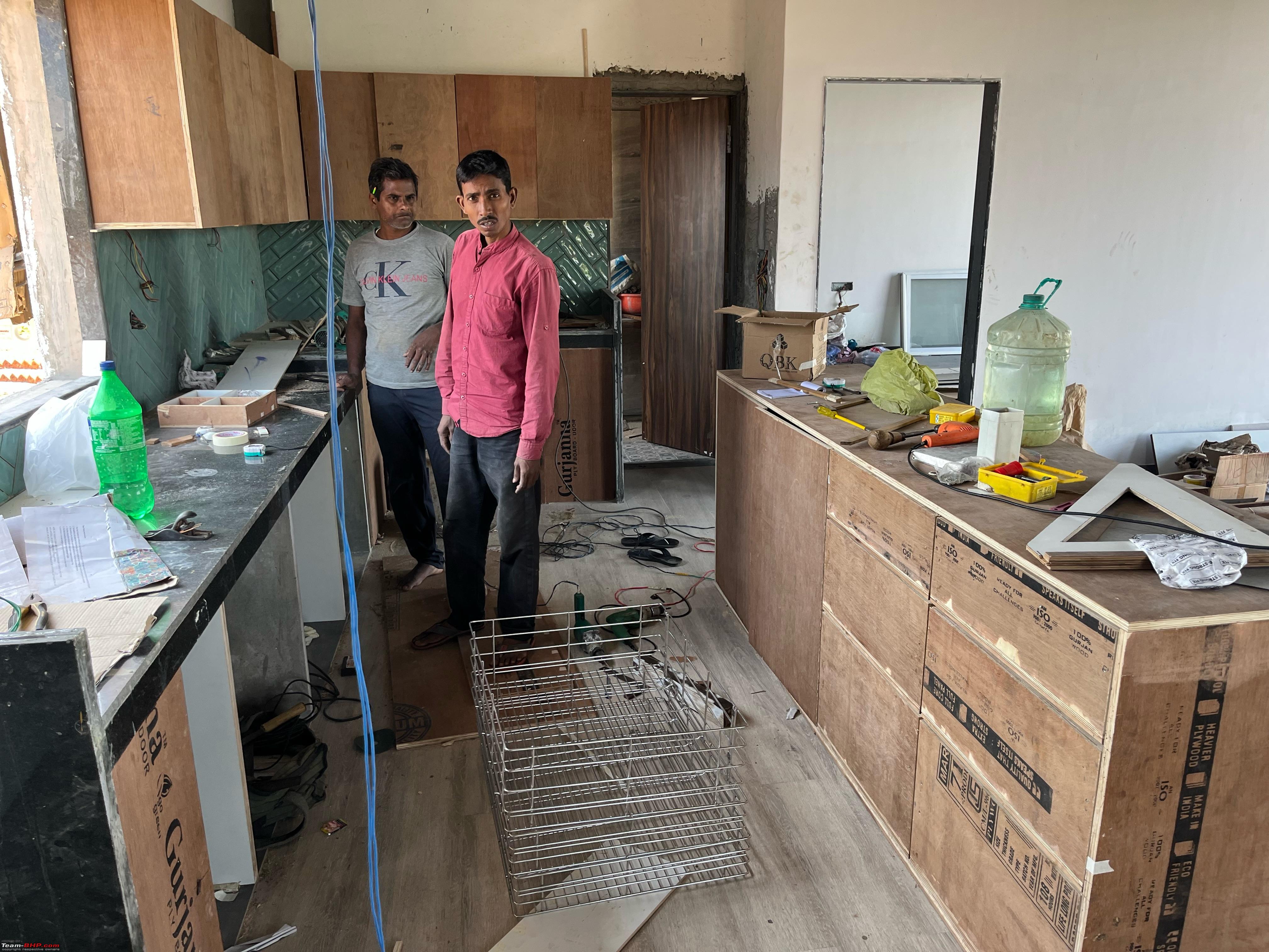

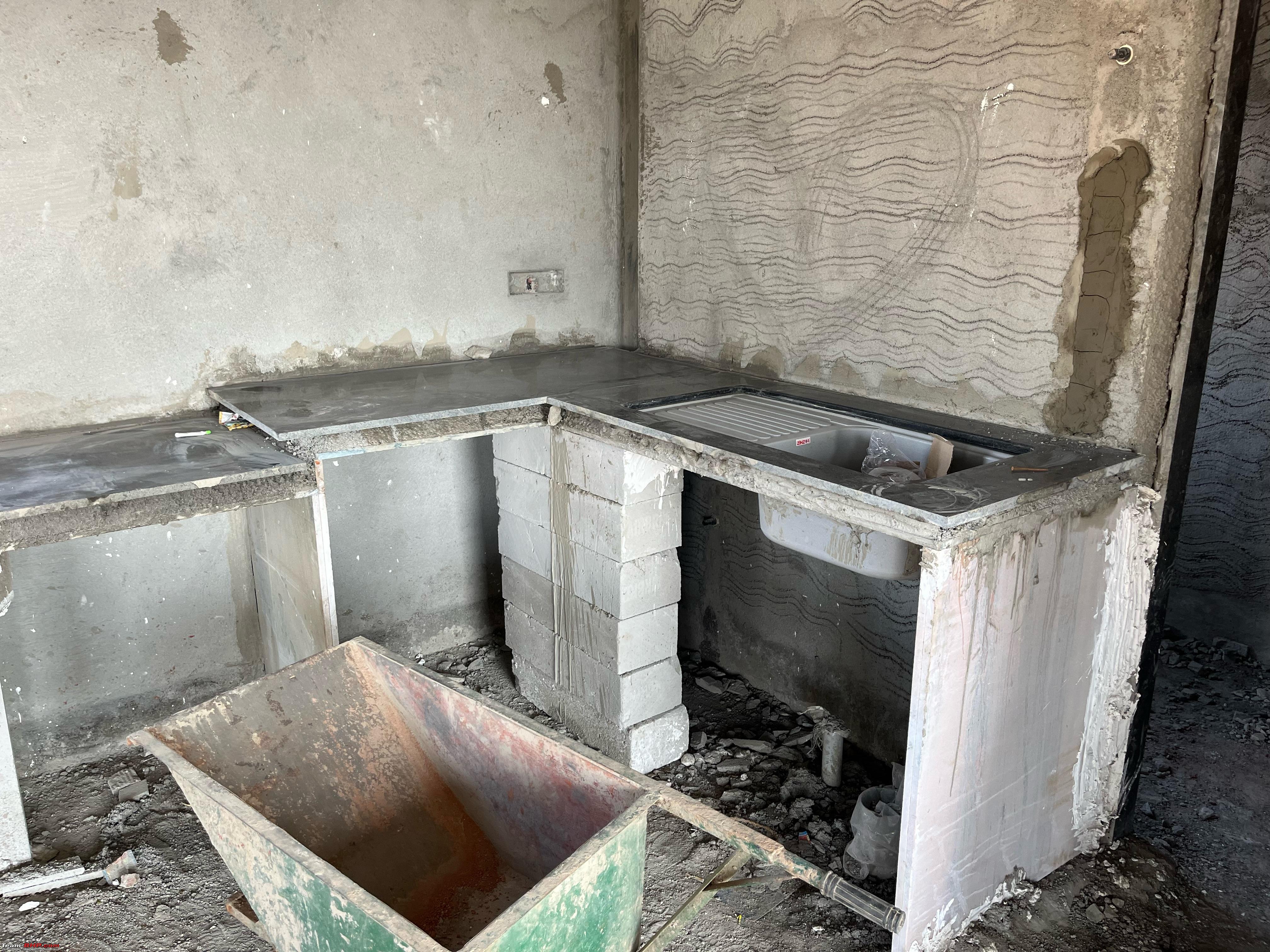

Kitchen Platform
Constructing a new farmhouse | Complete greenfield project-3fac311eb8d44479a9981c89db4c6430.jpeg
Constructing a new farmhouse | Complete greenfield project-194cc596c8974a08bf3cfc84468f838e.jpeg
Constructing a new farmhouse | Complete greenfield project-b3fc981ea802481c8dc30d1a1dadae96.jpeg

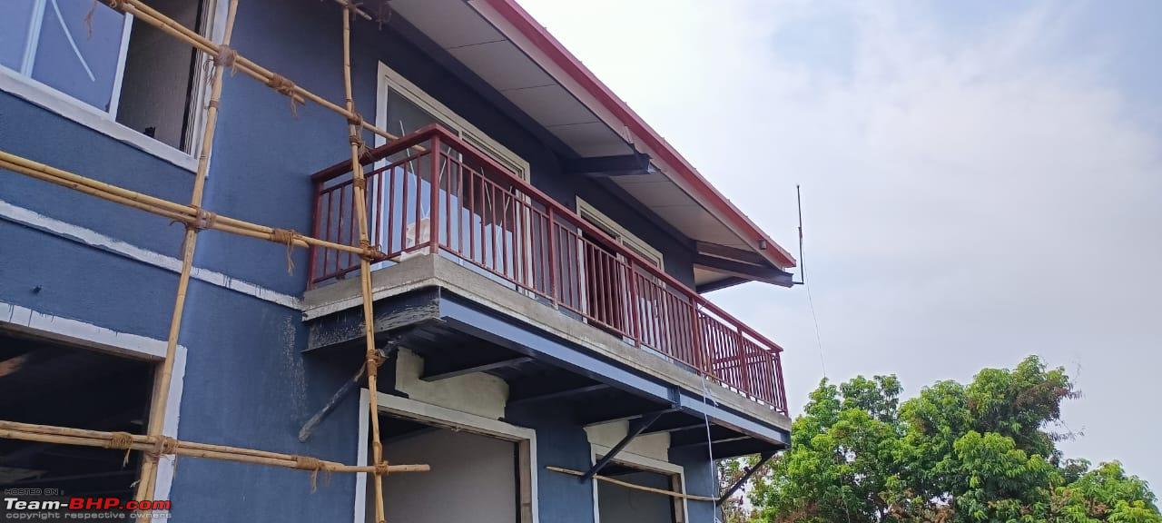

Balcony railing
Constructing a new farmhouse | Complete greenfield project-e9d318faa6dc4824aa44193588efe485.jpeg

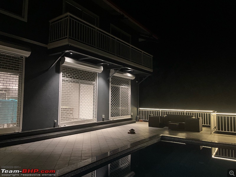

The Farm house is finally complete. Took a total of 6 months 22nd October 2022 to 21st April 2023. We spent our first weekend there. Some art work and minor work is still pending along with landscape which I will start in monsoon.
Last 15 days was hectic since I set the target of 21st April 2023 which is my sons birthday but it was all worth it.
Some teaser pics attached. I am going to do a proper photo shoot the coming weekend. Once that is done I will post each room with description.

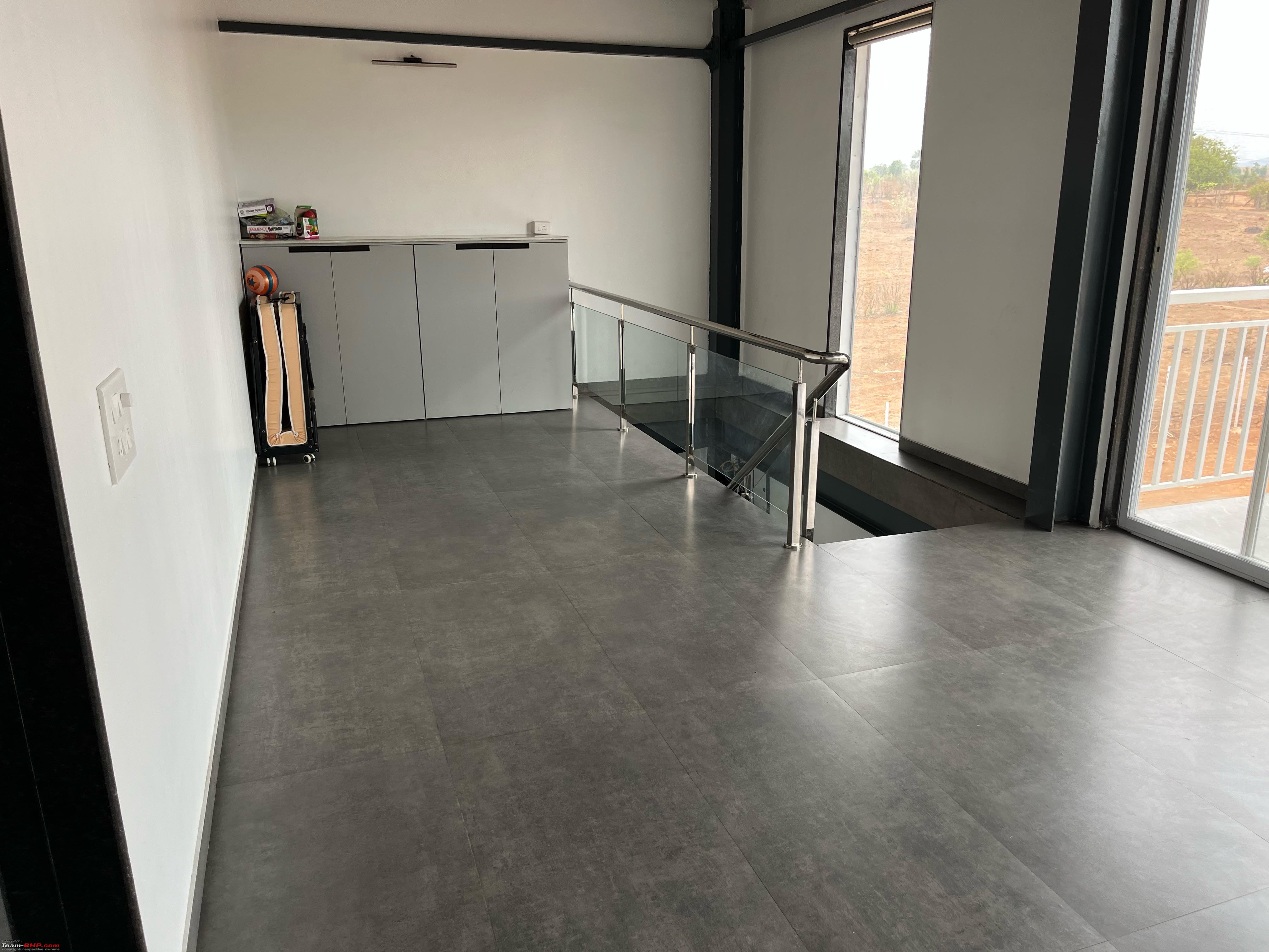

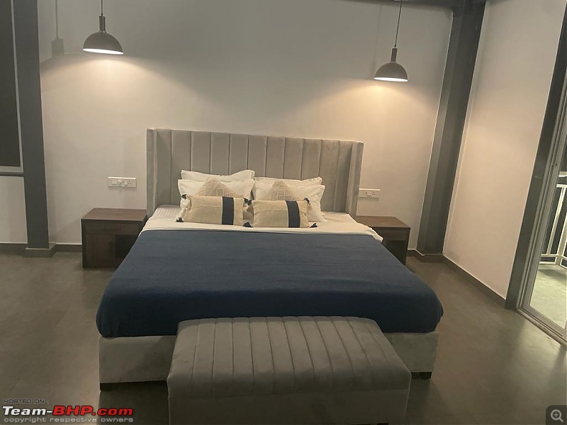

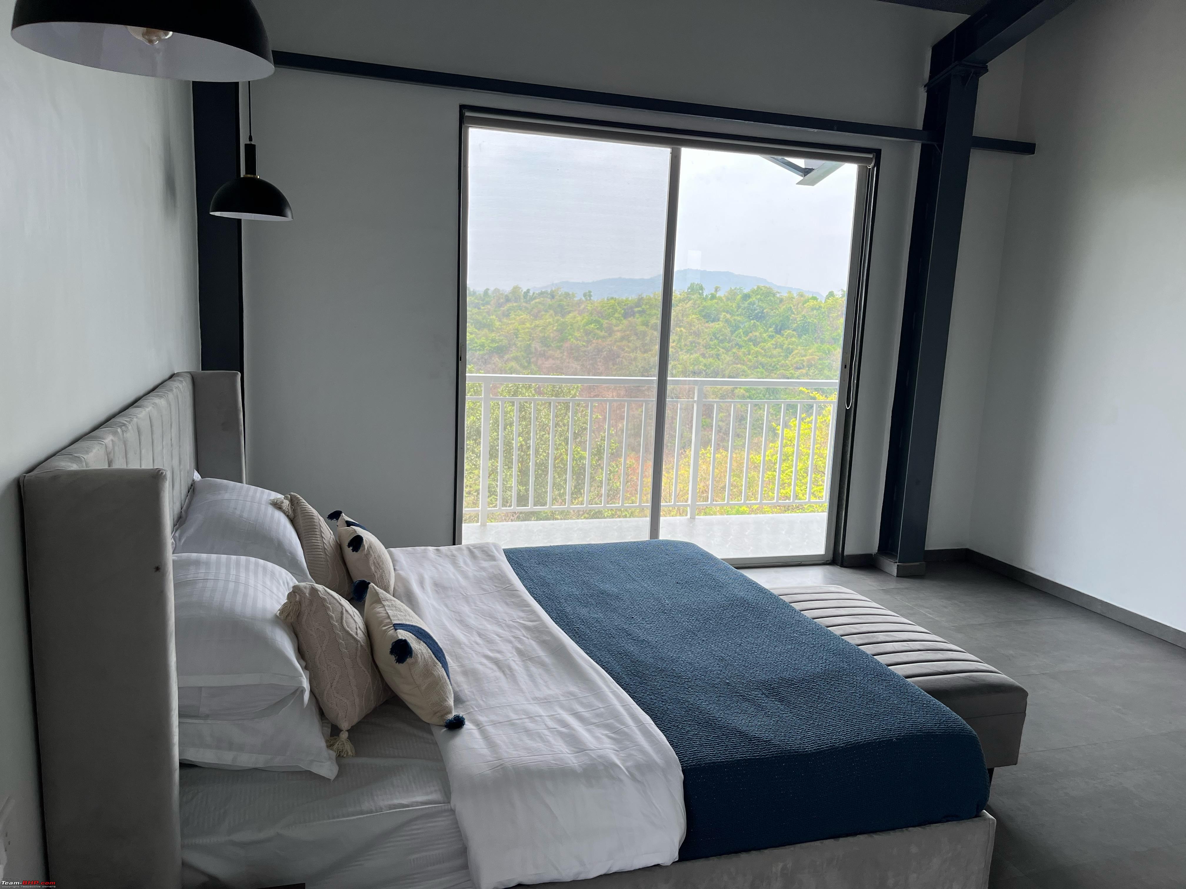

Thank you all for the wishes. The past 6 months was fun and now that the house is ready we cannot get enough of it. Here are some pictures with brief information about the house.

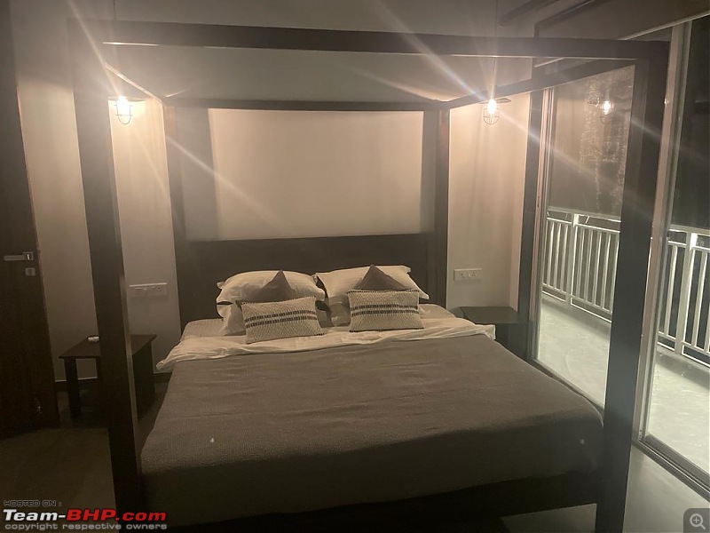

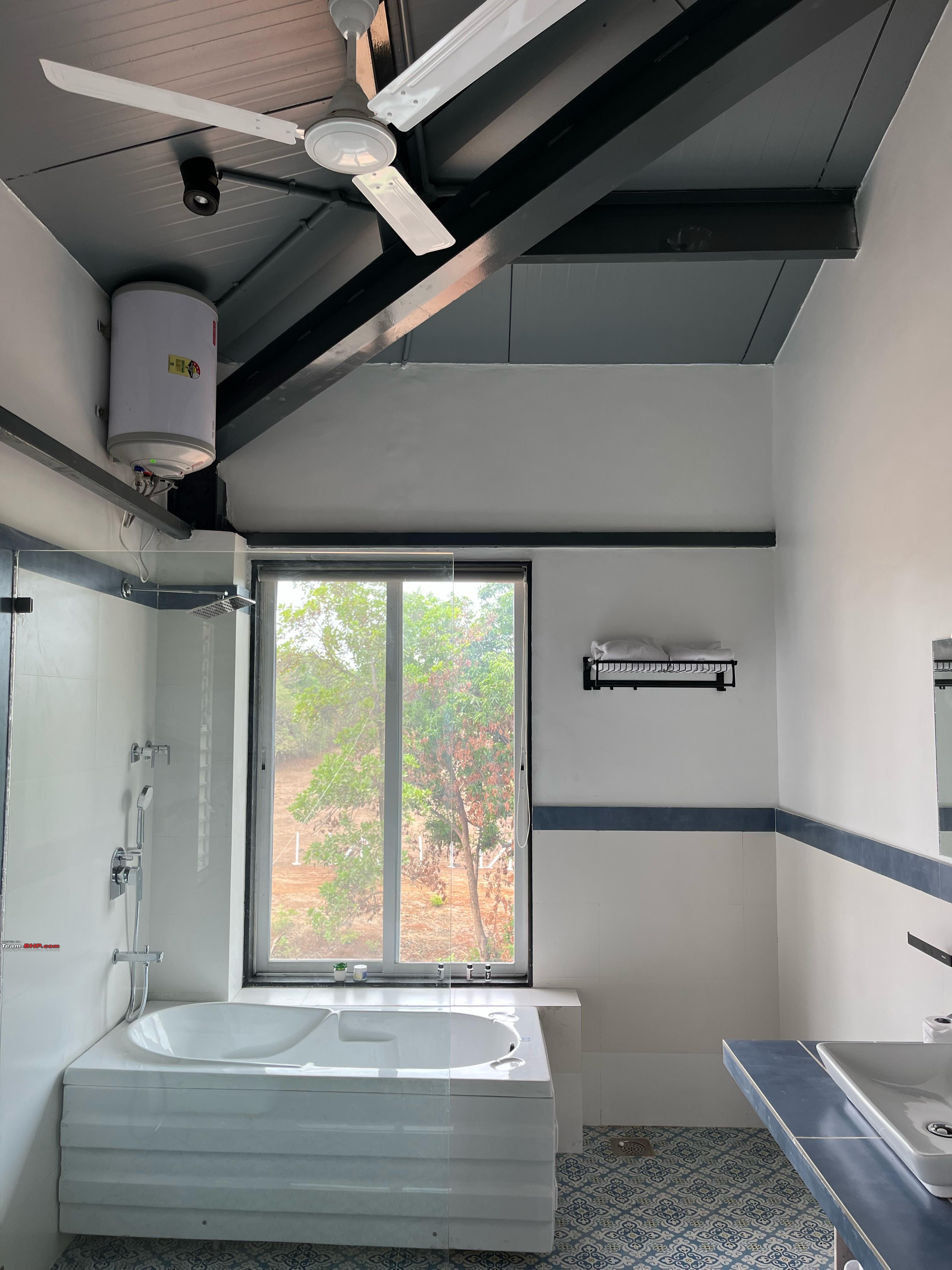

1. Master bedroom
The master bedroom is on the first floor. It is the smaller of the rooms but has the largest bathroom. There is balcony along the length of the room which also connects to the Kids bedroom. The poster bed was bought online from Ganpati arts.

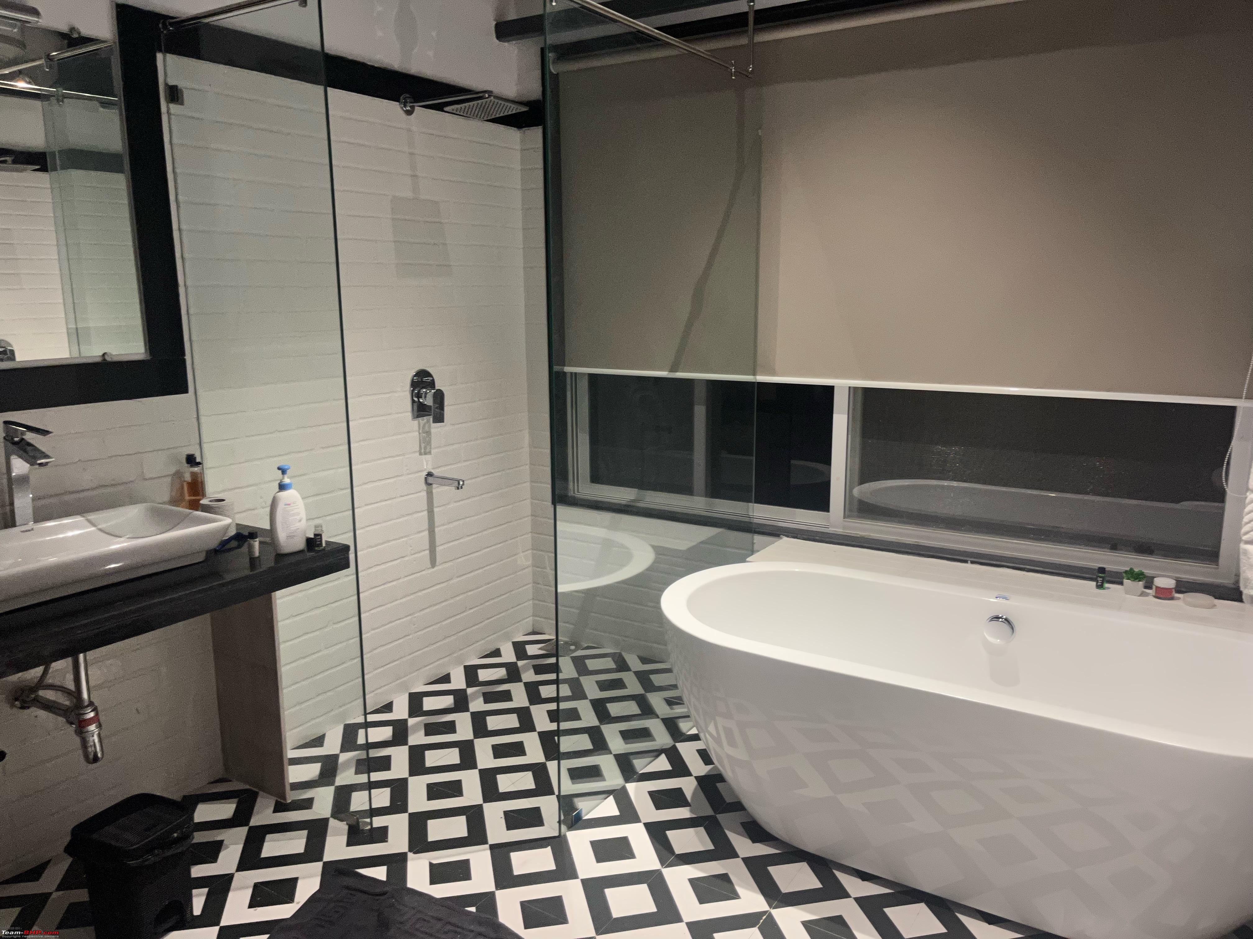

The bathroom has a stand alone tub and a separate shower cubicle along with the view of the entire valley. The wardrobe is from pepper fry. Actually 90% of the furniture is from pepper fry.

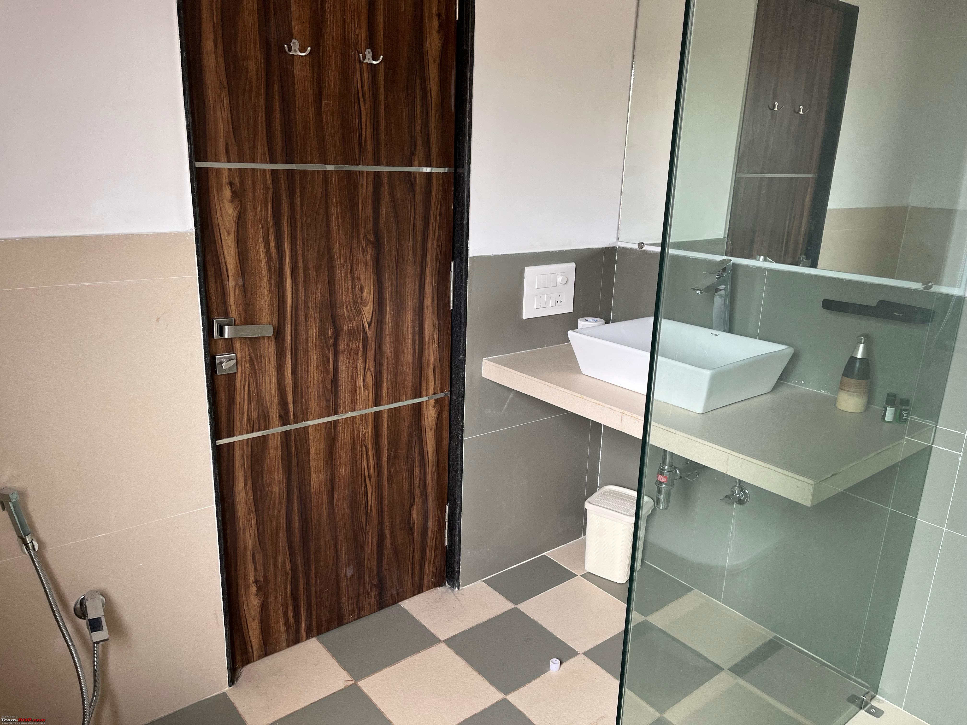

3. Guest bedroom
The guest bedroom is on the ground floor and is wheel chair accessible. This bedroom has direct access to the pool and patio area.
The bathroom is the smallest with a shower cubicle.
