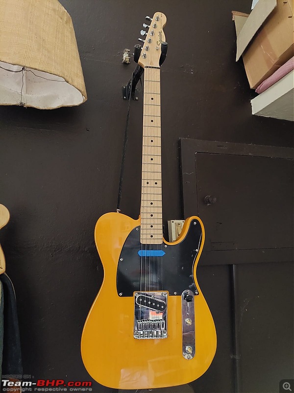

So this is a guide on the upgrades that were done to my Squier Affinity Telecaster electric guitar. I replaced my guitar’s pickups, wiring and electronics. There are a lot of write-ups and videos on upgrading Squier Stratocasters, but not a lot for Telecasters (especially Squier Affinity Telecasters). I hope this would be of help to those who would be looking forward to upgrading their guitars (especially this model).

I thought at length about what I wanted to upgrade in my guitar and decided that I would replace the pickups and the electronics for starters. I searched low and high for those parts in India. As expected, they were either unavailable or were extremely expensive. I got all the below parts from USA.

I came back from his place with a lot more insight, admiration and a seriously wicked guitar that could hold its own against guitars twice or thrice its price. I’ve been playing it for quite a while almost daily and it sounds and plays noticeably better than before. Alister is also planning to make custom guitars for discerning customers. I’ve seen a Les Paul type guitar he had made from rosewood (!) and it was terrific. The next one in line is a Telecaster type. Please PM me if you have any such requirements or work to be done to your guitar and are in Kochi or are planning to visit Kochi- I will share Alister’s contact details.
