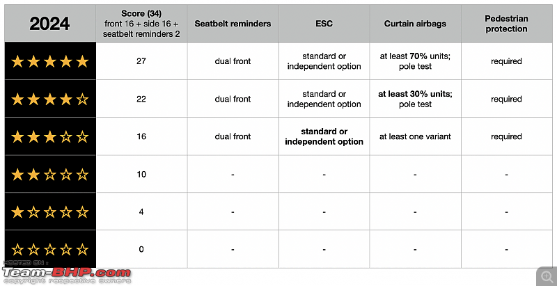

The changes for 2024 are more significant than you might think (highlighted in bold in the image below).
Changes for 2024
A car can no longer get 3 stars without curtain airbags at least on one variant.
For 4 stars, they cannot just be "offered" anymore but need to be fitted to 30% units sold.
For 5 stars, they need to be fitted to 70% variants - something even some of the 2022 5-star cars would struggle to meet.
Also, for 3 stars, ESC now needs to be standard or an independent option, not just "offered".
All of this should serve as a reminder: when looking at a rating, check the test year.

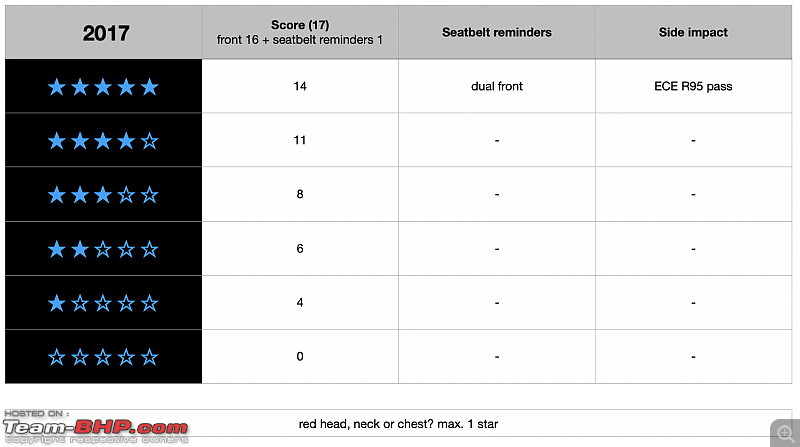

A very common claim is "if a car had n stars earlier and has not been updated you can subtract 2 stars and get the new result". The truth, however, is more complicated than that.
Here is how simple the rule for the old ratings looked in comparison:

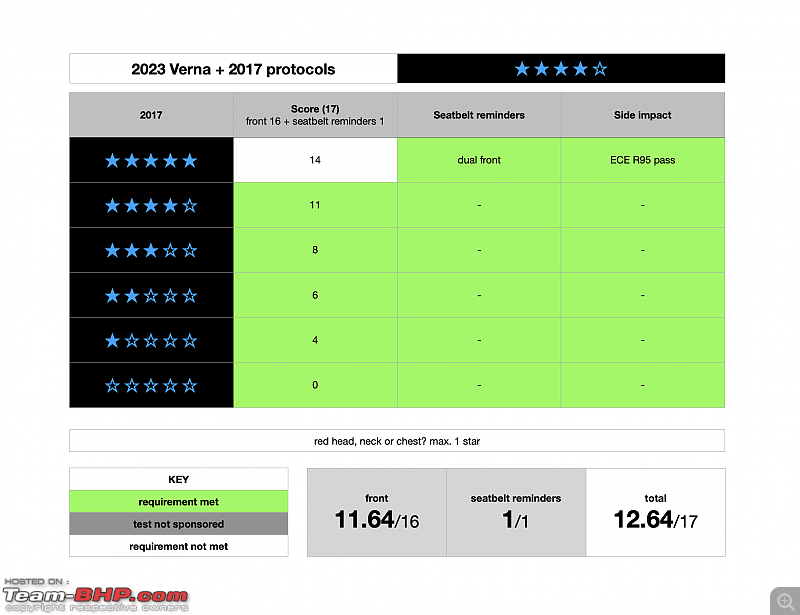

The fundamental idea behind NCAP updates is not 'stricter', but 'broader', i.e., the rating depends on more variables. And yes, it's possible that can cause the rating to increase. Case in point: the Scorpio-N and Verna would have scored 4 stars if rated earlier.
This is how the latest Verna would have scored if tested before 2022:
Which is why "broader" does not necessarily mean "more stringent".
