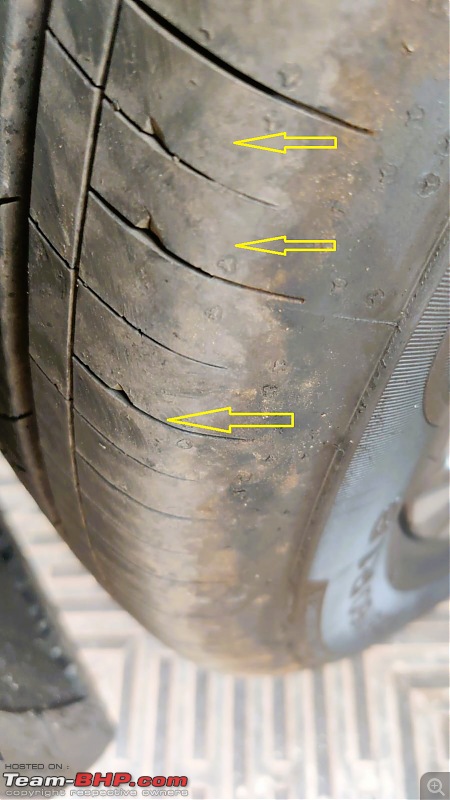

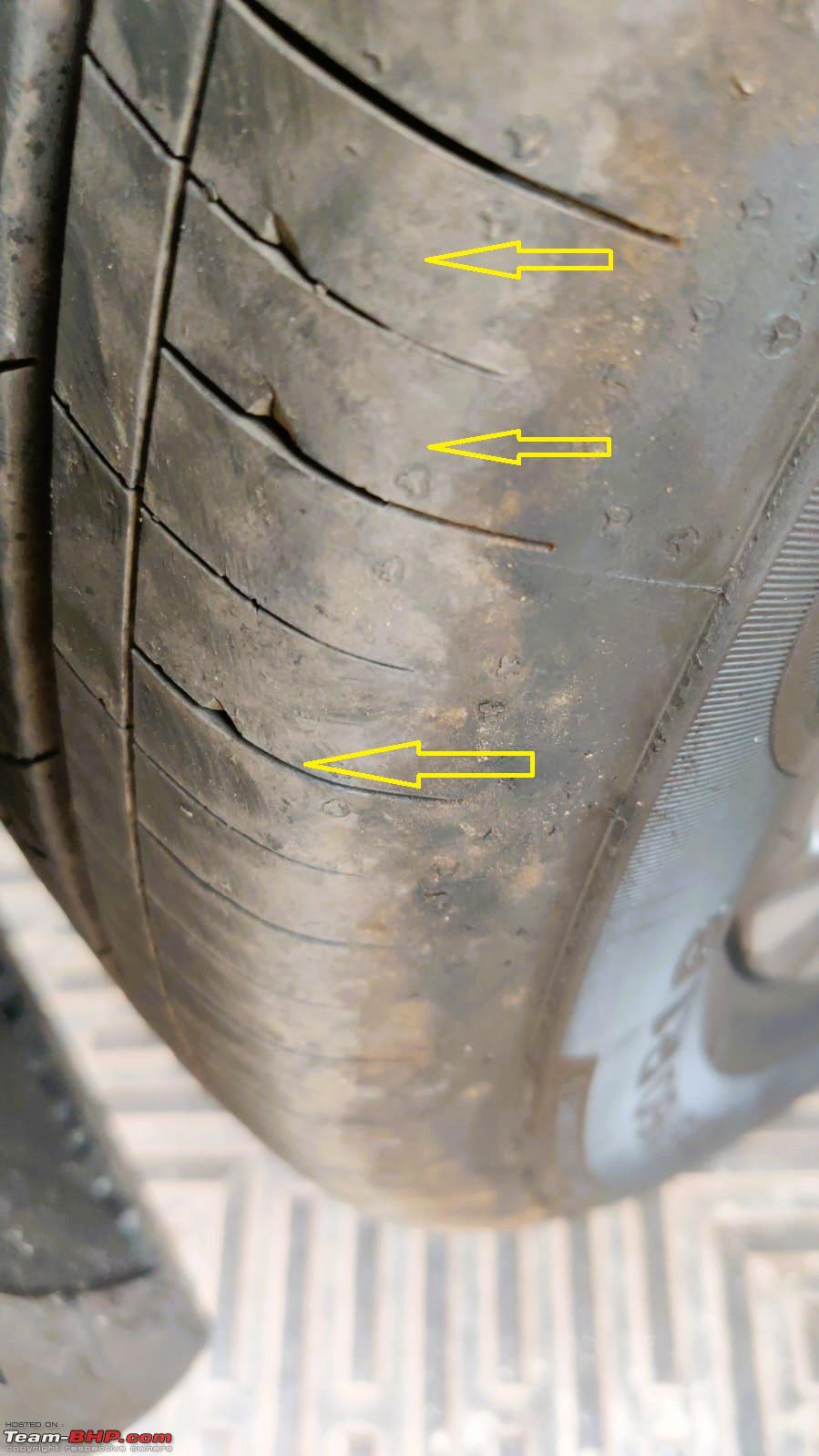

Around 1 inch cut in front right tyre through which air was escaping.
