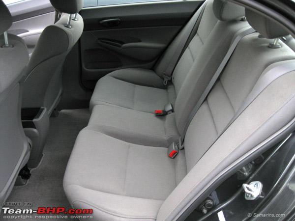

On the other hand, the seat belt on cars like Civic has a diff. arrangement; wherein the seat belt falls from the top and you can wear it across the body. This will ensure you don't crash forward.
As illustrated
Is there any way I can modify the seat belt arrangement (lap-type) to the conventional 3-point for the middle rear-seat?

I dont think even civic has it. I can confirm for sure after I check.
Is the 2nd photo of Indian Civic? Does not look like. The rear arm-rest is missing. It has a head-rest for middle passenger. The front arm-rest is also somewhat different.

Well, Civic or BMW; the point is not which car has that arrangement but how to have it on a car that doesn't have it during manufacture.
I just typed Civic in Google and that's the image I got; I couldn't get a picture of an actual car with that arrangement sitting in office!

You're right, the Indian Civic comes with a lap belt for the middle passenger in the rear bench. The photo seems to be of a different variant model compared to the indian Civic.
That said, the lap belt is pretty useless when it comes to safety. Though it can be altered, but I think it will be difficult to do a neat job.
