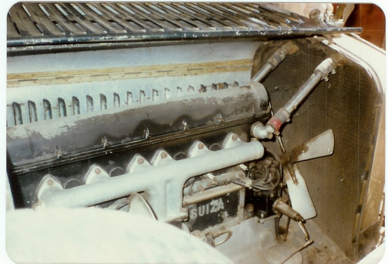

Two pictures of the Lucknow 1927 Hispano-Suiza H6B’s engine before restoration.

Did Delhi have the facility of pressure testing blocks and heads for leakages? I remember a Delhi restorer telling me a Mercedes engine he restored proved a nightmare due to this problem. I don't recall him telling me there was a facility to test.

I always pressure test every cylinder block/cylinderhead/petrol tank/ radiator by blocking all the holes with rubber bungs or soldering a plate and a tyre valve in one of them then pressurising them (only up to 8 psi for radiators or tanks) immersed in a tank of water. Then you track down the bubbles sometimes it takes many attempts. But its very essential. I also had a pressure testing hand pump set for testing assembled cars.
I think they had major problems because the Mercedes cylinder block was part of the crankcase so it was huge and you'd need a big tank. You can do it out of a tank by wetting the surface and watching the bubbles but its much better to immerse the item in a tank. With some tanks you have to fight the buoyancy to keep it underwater. I did my 2 motorcycle tanks in the bath at home when my wife was out.

Now that's a tip everyone restoring an engine should follow.
Julian its obvious you've had some of the most rich experience in restoring these exotics. There's a possibility you may have encountered mistakes in the beginning and learnt to avoid them as time passed.
May I urge you to start a thread on a guide to restoration. This could be a simple to follow list of checkpoints all restorers should follow. Mistakes during mechanical overhauls are time consuming and expensive to correct. Sometimes a simple check can save yourself huge headaches later.
We could start with the engine, the gearbox, differential, the brake system, the electricals, the steering, the chassis, and suspension items
Please do consider sharing your experiences and knowledge in this form so many others in time to come can refer to the checklist to avoid mistakes and improve their restoration effort.

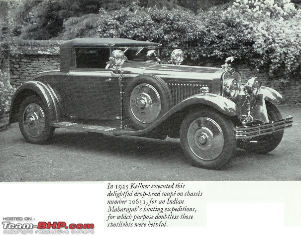

Another one, anyone know who it went to?

Are not the following pictures of the same car?
To me they look to be of the same car. Glad its survived. Albeit a case of over restoration (looks horrendous). Its so obvious the best standard for restoration is to return it to the condition it was in when new!

DKG, i confess, i don't know anything about these cars, but love reading through your thread! But don't the two cars posted above look like different ones. Im sayin this coz i feel there is a small difference in size of the passenger cabin and roofline. Or is it just due to the way the pics are taken?

Lets look at them closely, do you see differences? I was looking at the door design and the lamp etc and felt its the same, but I could be wrong. Please share your observations
