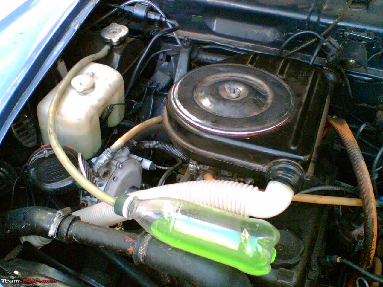

It is better to stick to original radiator of padmini rather than going for alteration for sealed type radiator. My S1 had problem with faulty thermostat switch. I tried M800 switch, but it fail to perform good in a Padmini.
So I altered as below.
The FIAT 1100/Premier Padmini Technical Information thread-image0417.jpg
The FIAT 1100/Premier Padmini Technical Information thread-image057.jpg
The FIAT 1100/Premier Padmini Technical Information thread-image0415.jpg
The FIAT 1100/Premier Padmini Technical Information thread-image041.jpg
