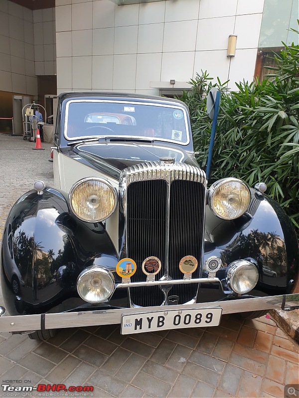

Having started the day at 0430, shuttling between Kochi, Kolkata, Bengaluru and finally to Coimbatore, I was looking forward to reaching Vivanta and hitting the bed. Alas, destiny had other plans. Reaching the hotel and stepping out of the car, I spot this beauty. Ditching my first officer, I went straight for her. Somehow, my mind convinced my body to stop thinking about how tired I was and take it all in. Stood staring at her for a good couple of minutes, did the customary walk around, admired her timeless curves, snapped a couple of pictures. Sir, you truly have done a magnificant job. Peace
Air_Kerala is online now   (10) Thanks
