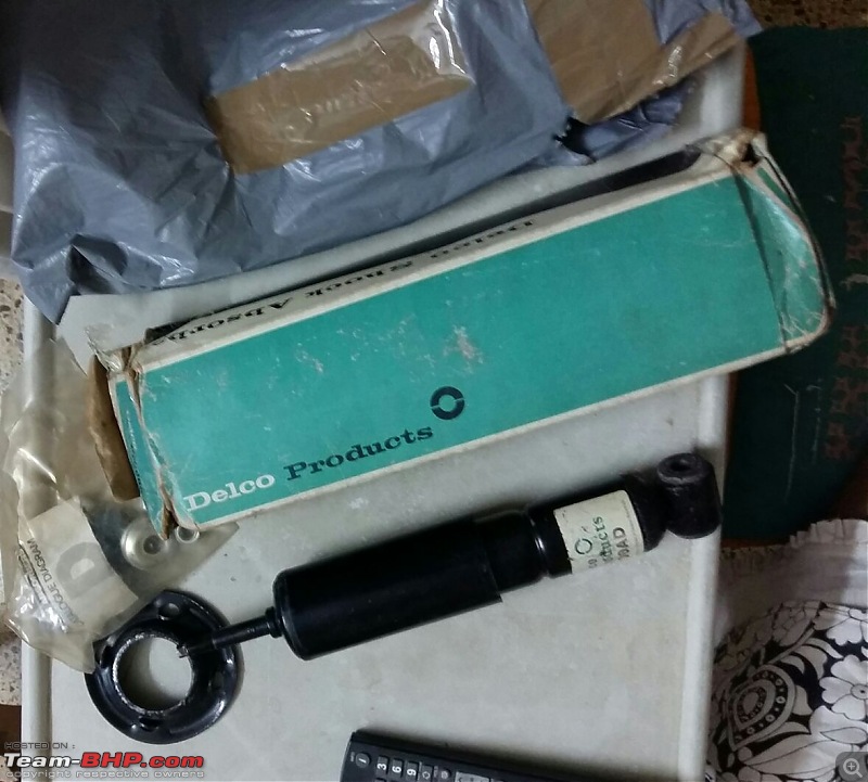

Old shock absorber compared to Herald units
Luckily one NOS unit was procured.
One was beyond repair, the other 3 were overhauled.
