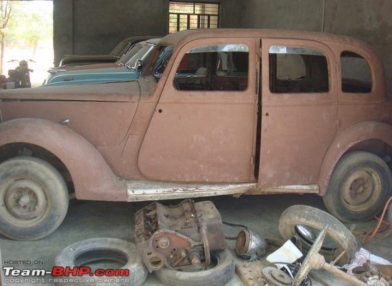

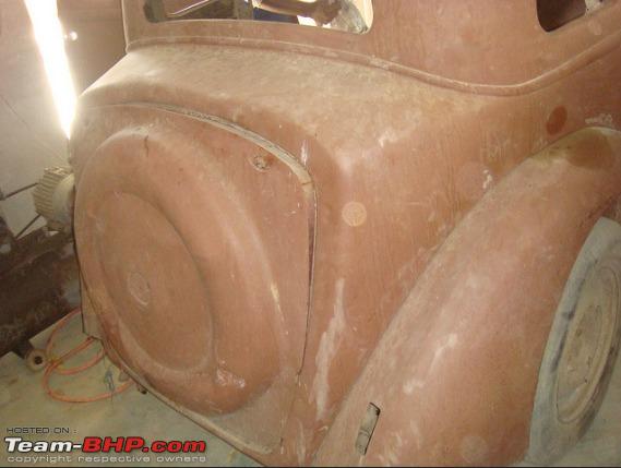

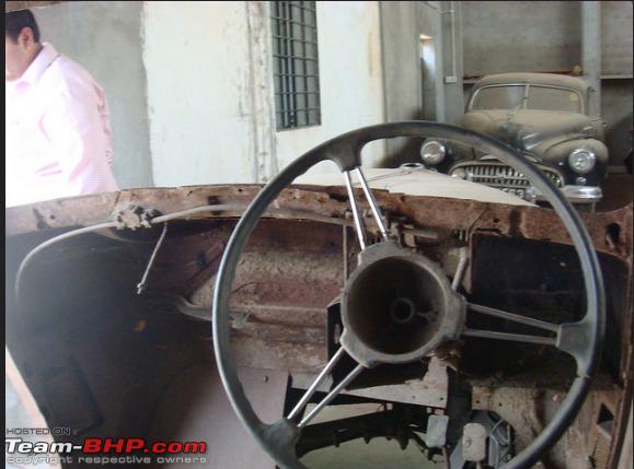

Finally I got the delivery of the car and we unloaded at a friends farm, who also has a great collection of cars and owns a workshop here in Jaipur.
Here are the pictures the first time I saw her in person, notice the bits and pieces and what a total mess it was. I will let the pictures do the talking.

Restoration: 1948 Rover (P3) 75-6 Light Saloon-missing-dash.jpeg
I had bitten the bullet and had a choice to abandon the project and mark it as a total loss or to get on with the challenge, I went in for the latter and though it has been a tough as well as enjoyable project, personally I would not suggest anyone to embark on such a project with so many missing parts, but I think one learns with experience.
