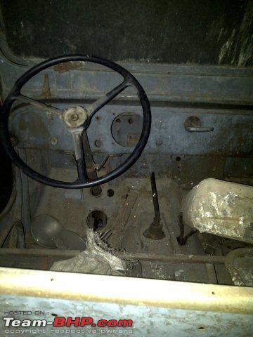

here are the pics of my jeep,i removed the headlamps as they were original prestolite made in USA written on them ,will try to retain the glasses and change the reflectors

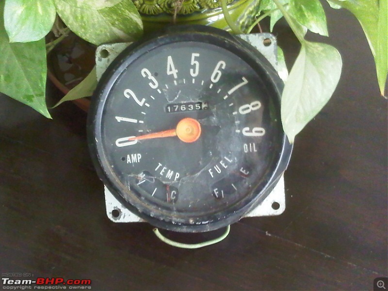

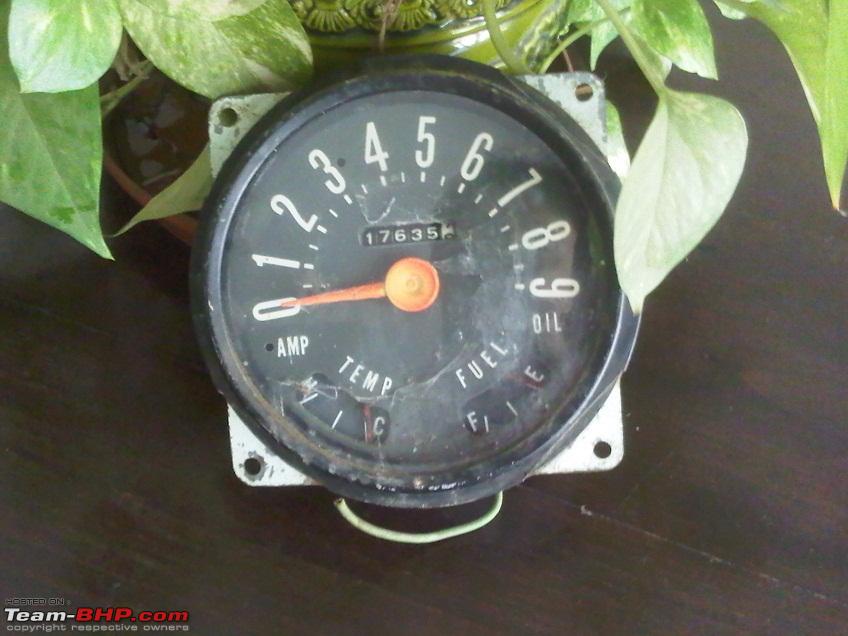

3b's from 53 to end 56 had a 5 meter cluster on the dash. The single meter unit was introduced in early 57. The L shape hand break lever was removed and in its place the T shape handle introduced in the early 60's in fact 61 to be precise. Thus your jeep must be between 57 to 61...
here is an interesting article for dating a Cj3b based on interiors.. Interior Details on the Jeep CJ3B Page
Regarding a single meter cluster:
-if you are keen for a MPH meter, I would recommend ebay.com , you will be able to find one anywhere between $30 t0 $145 depending on its condition. The one you see on my dash was for $55.
-If you are keen on a KPH, then those are available here in India and are priced Rs.1500 upwards.. Although you will have to do a bit of searching...

sir, i was wrong for the hand brake and rechecked yesterday again and clicked a pic too, the brake is T shaped and dash has one big whole for a single meter and switches just as your dash seems to be, being new to the jeep stuff,pls suggest what year is it the RC book reads 53 and in the name of Govt of Punjab and hence exempted for tax,but i had to pay from the date it was auctioned and tfred in my name,another interesting fact is the jeep is not with OHV engine it has the side valve engine and the engine number too matches the RC book,whats the mystery
A 'go devil' engine in a Cj3b from a govt department is strange.. I have never heard of one and would attribute it to a engine transplant sometime during its service in the govt. The T hand break and a single big meter confirms that your jeep is a post 61 and pre 66 as thats when we start seeing JEEP being embossed in india and some early ones were LHD as well.
Anyway, a few questions come to mind regarding your jeep:
1. What is engine serial number? and the block casting number? ignore the RC please check the engine itself. (you will find the engine number on the boss above the water pump OR behind the oil filter. The casting number will be on the passenger side of the block at the bottom)
2. What is your chassis number? again check the jeep and not the RC.
3. is your tool box lid curved at the edges or is it square in shape? a photograph would help.
Please remember that gauging the year of manufacture of any vintage jeep by the entry on its RC book would be futile. The serial number and a few other clues in design and body changes can be more reliable. I own 3 jeeps and none have the correct year mentioned on the RC.
