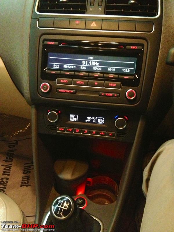

Just saw this photo posted on the other Vento thread (VW unwraps the updated etc) and noticed that the new refreshed 2012 Vento comes with a Cigarette lighter and an ashtray.
Well what i wanted was that orange/red color illumination around the lighter, the cubby hole in the Vento is quite deep and in dark finding something inside is a task in itself.
As my Vento didnt come with a lighter, i borrowed my friend's from his Rapid but it didnt glow, any clue as to what it would be?
