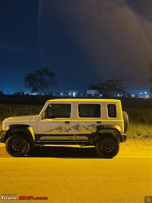

Changed the grill, added a cupholder and upgraded the tyres to 235/75/15 Roadcruza AT’s. Did a mild offroading as well.
No rubbing anywhere as of now.
