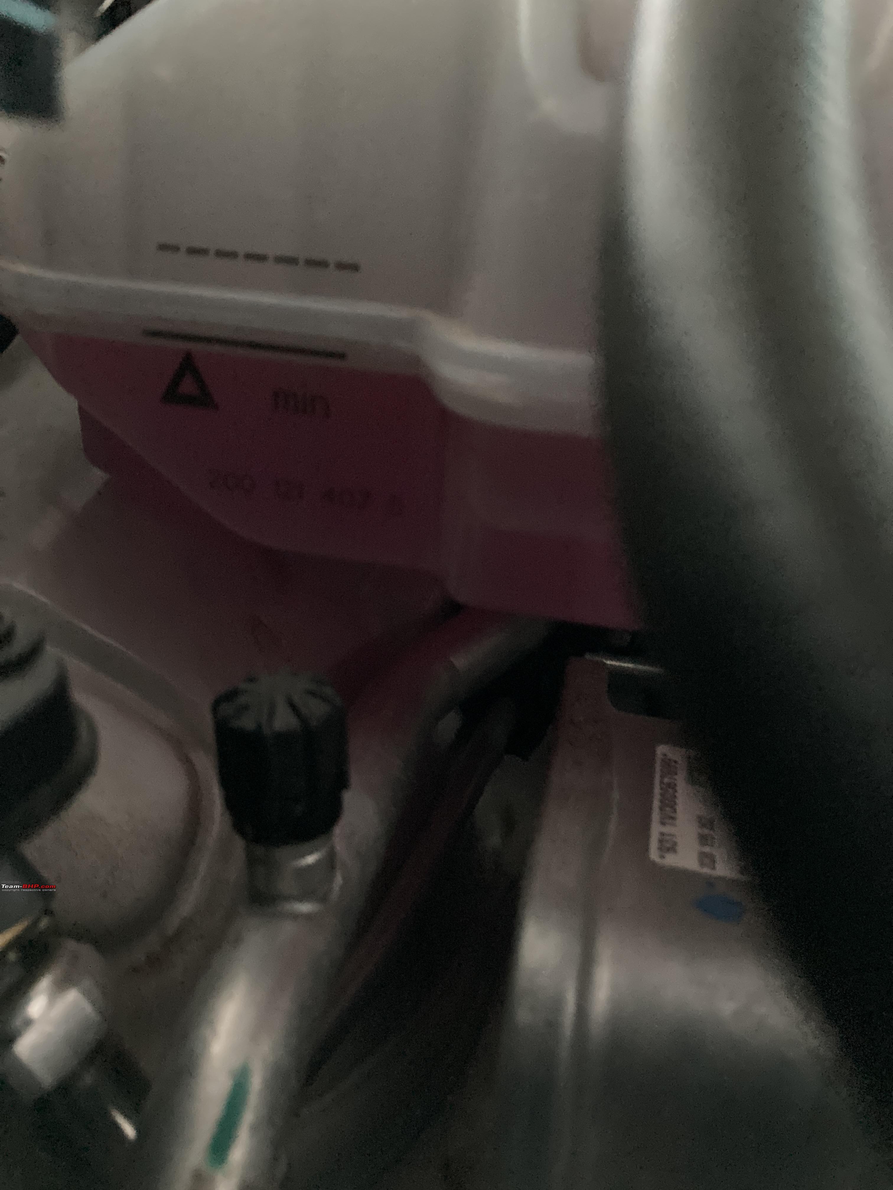

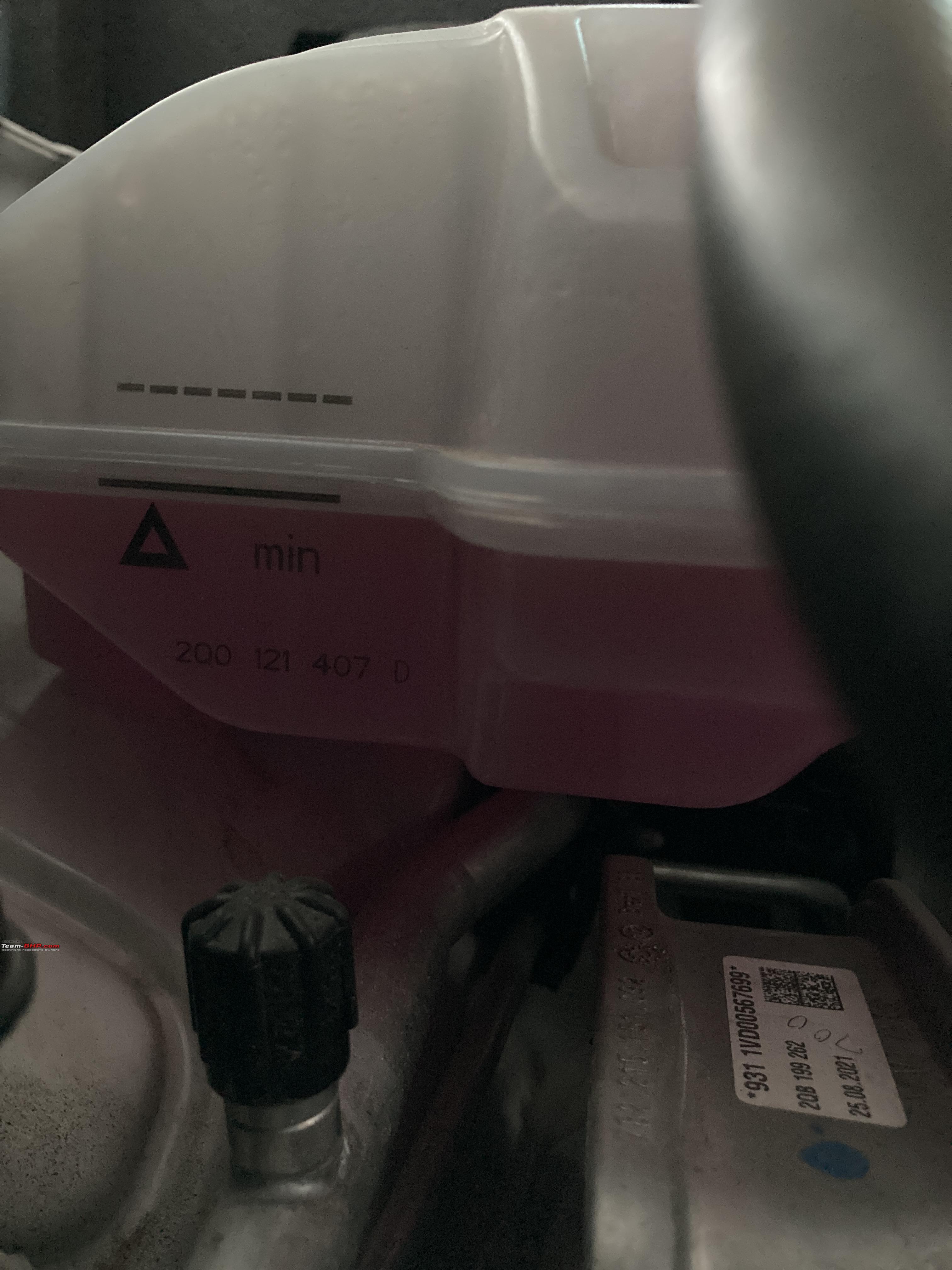

Greetings Fellow Bhpians!
I was checking all the fluid levels of my Kushaq and found the coolant level to be a bit low.
Please suggest if this coolant level is alright or shall I put in distilled water in it.
Regards
Ranvir

You will get VAG recommended red coolant in most of the big petrol bunks, definitely it’s in Shell. So you can fill it and see for few days whether the level drops more than normal.

Same with my car. As far as I understand this is a coolant expansion tank and the coolant while engine is cool will stay at the minimum. As long as it doesnt drop below it it must be fine.
Follow these steps:
1. What was the coolant temp when you checked the level? Check again at 90 C which is optimum temp for the coolant.
2. If it is still low, check for leaks under the engine bay. Could be a small pinhole leak in the main hose that goes in to the radiator. If no leaks found, do this:
3. When the engine is cool, open the lid of the coolant tank slowly, the moment you hear air hissing out, briskly open it fully. DO NOT DO THIS WHEN COOLANT IS HOT!! You should hear a "POP" of air at this point, and if the level rises to normal after this, do nothing, observe level again at after 1000 kms.
4. If there is no change in the level, top up till little under the max level, with recommended coolant from your dealer. Only use G12 evo coolant which I think is the standard coolant for all petrol and diesel Skoda / VW cars nowadays. Observe after 1000 kms.
adi_petrolhead is offline   (1) Thanks

Well this happened with my Taigun a month back. Suddenly, I got a message one morning coolant level low. The coolant was below minimum level, I went to the SC after topping with filtered water. They checked the car completely found no leak. Conclusion they gave was due to summers the coolant must have got evaporated and from factory only the level would have been low.
My friend just picked a Taigun, couple of weeks back and I went for the PDI. I found the coolant level just a little above minimum in his car as well. Maybe the QC is not doing a good job of checking coolant level.
TJ02 is offline   (2) Thanks
Originally Posted by adi_petrolhead View Post
Follow these steps:
Thank you guys for the replies
I also confirmed the same on a call with Skoda Service Centre and they said it is perfectly normal for the coolant to stay just above the minimum mark when the engine is cool. They asked me to observe it when the engine is hot and I did the same and found that it was right at the maximum mark.
So nothing to worry about.
Regards
Ranvir
