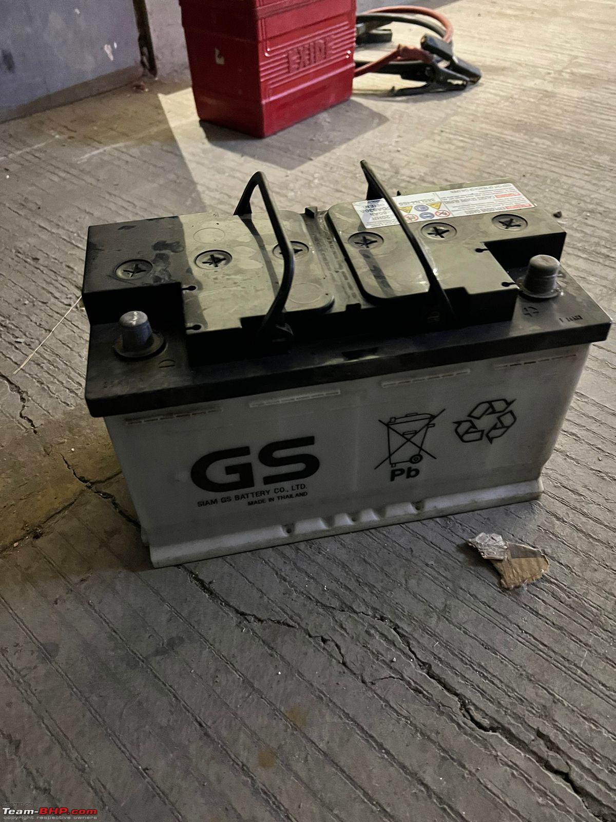

Originally Posted by abhi1881 View Post
Hi , Need advice. I have 2021 April Fortuner. Lately the Auto stop/start frequency has been reduced and usually the message on the display console is Battery Charing. Is this time to replace the car Battery?
So one fine day, the battery decided to die on me!
Absolutely no warning signs except for the 'Battery Charging' sign on the MID, a few days earlier. And mine is a April 2022 4x4 AT.
So battery died in just 20 months of usage! Very bad quality for a Toyota!
The OEM battery;
2021 Toyota Fortuner Legender & Facelift Review-whatsapp-image-20240116-2.50.30-pm.jpeg
Replaced with Exide, 30+30 months of the same capacity (80Ah)
2021 Toyota Fortuner Legender & Facelift Review-whatsapp-image-20240116-2.51.37-pm.jpeg
Price paid - 9400/-
The battery dealer told me, cars with Stop/Start system give up early.

Originally Posted by powertrain View Post
If you don't mind sharing, how much did you pay for it? How's the camera resolution?
It came to 32K before GST, the resolution looks good, but it might be too early for such feedback since I have driven only few hours post fitting this
Looks like it was a good decision for me to get the battery checked and replaced before it died than stranded in someplace where no support available

In today's world where the typical battery warranty is 3 years, I am wondering if it is acceptable by the quality standards to have batteries that fails in less than 2 years in a premium vehicle like Fortuner that is know for it's quality.
Is there a way we can make sure this issue reaches the Toyota higher-ups? Can we run a poll to check if these are stray incidents or it is a mass fault caused by a design defect than anything. We can expect issues with even the new battery if it is design issue created by auto start-stop or some other aspects

Originally Posted by padmrajravi View Post
Changed my car's battery today at 2 years and 27K KMs. It was taking slightly longer to start for the last few weeks. The auto start-stop was also not working. Not that I care about the auto start-stop, but I felt something was wrong with the battery. I had a few long drives coming and hence checked the battery at the neighbourhood battery shop. It failed the crank voltage drop test. The voltage was dropping well below 8V under crank load. Changed the battery to an Exide 80DIN with 60-month warranty. The cost was 9K after exchanging the old battery. The old battery was 'GS' brand, something I had never heard about before. Anyway, at just above 2 years, this is the shortest life span I have had with a car battery.
Originally Posted by gadadhar View Post
During the last drive to Kerala, it became very evident that the start stop function was not working the way it used to be with the message that battery is charging, also there was some difference in the cranking sound. On inspection, the battery was found weak and was replaced with Amron. Stock battery warranty is only for the first year, so the value of old battery was only the residual price on exchange . SA commented that Toyota should equip Fortuner with a better battery that should sustain 3 yrs+.
So that is 4 batteries gone in 2 years including mine. All 4x4 ATs. And that's only in this thread. That is a very high failure rate for the supposed reliability king. What can we do about it ? May be send an email to their customer care ?
We should do something about this, the issue may reoccur with the new battery if it is a design problem. Hope the BHP experts can guide on the best way to take this forward with Toyota
