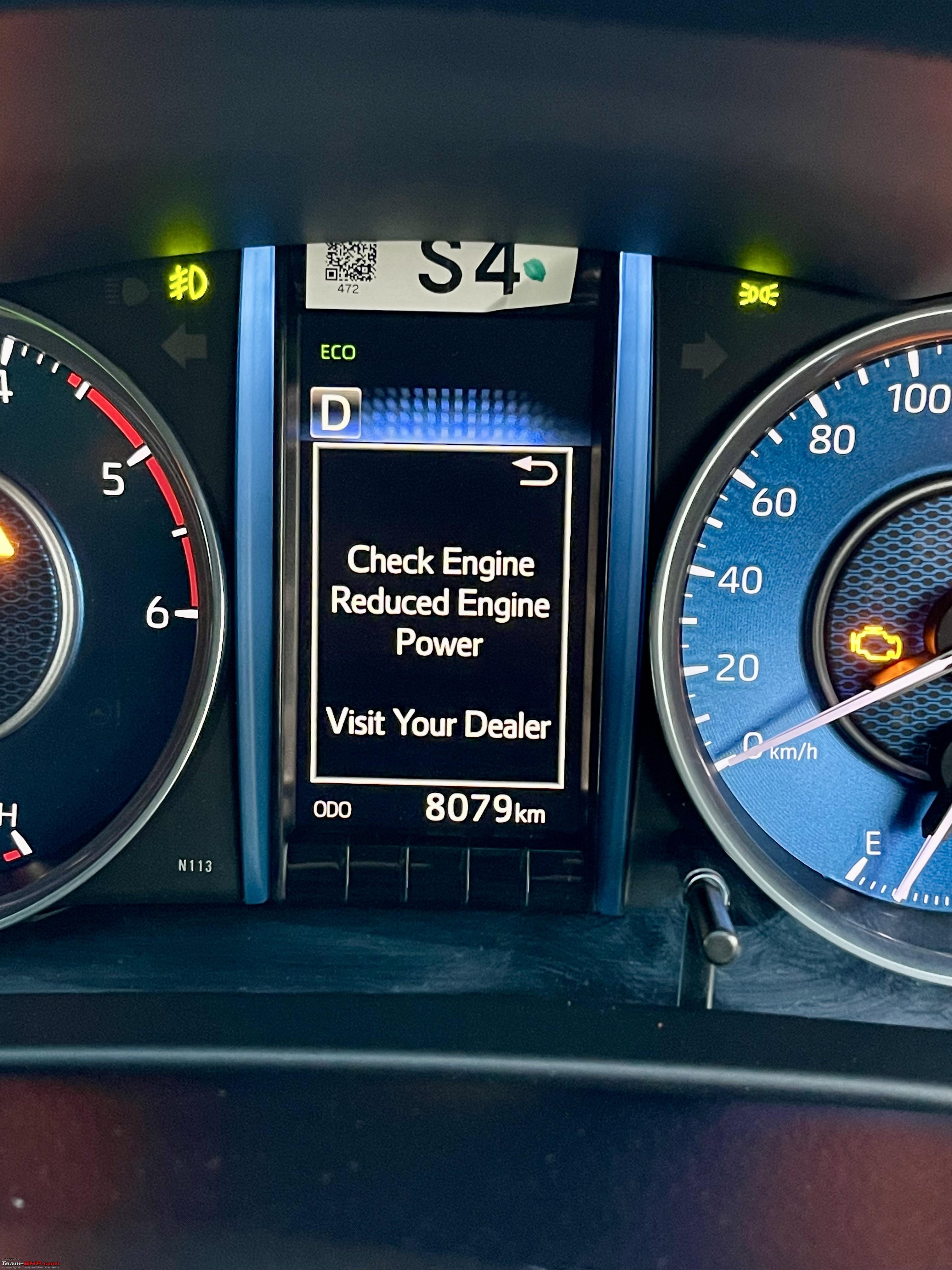

Originally Posted by t2k4 View Post
Got the DPF Full, visit dealer on my Fortuner 4x2 Diesel.
The SUV has completed 7,700-odd KMs till date, has had the first service last month and got the AdBlue refill at 7K.
Second DPF full failure.
300-odd Kms after the 1st one.
Between the previous clean-up at the dealer and this msg, there was one auto regen. I tried manual regen button on three separate occasions but it didn't allow me to trigger it saying it wasn't needed.
Then, this morning, the DPF full message.
Took it to the dealer; they re-did the same process as the 1st time. Took an hour or so.
They promised to also ask Toyota about this and evaluate if Fuel Injectors need to be replaced.
This is getting very frustrating.

Old 28th September 2022, 11:32   #999
cool_dube's Avatar
Join Date: Sep 2004
Posts: 2,701
Thanked: 4,702 Times
Re: 2021 Toyota Fortuner Legender & Facelift Review
This is concerning, for sure. What has been your usage pattern over these last 300 km? Mostly city driving with heavy traffic, or highways as well? Also, could bad fuel be a factor?

Old 28th September 2022, 11:38   #1000
Join Date: May 2016
Location: Chandigarh
Posts: 141
Thanked: 593 Times
City only with moderate traffic.
I always refuel at company-owned stations, but hard to say if Chandigarh receives BS6 fuel. I asked the Toyota technician about using Turbo Diesel and he shrugged it off saying 'uske saath bhi ho jayega'.
t2k4 is offline   (1) Thanks
Old 28th September 2022, 11:40   #1001
Join Date: Jan 2022
Location: Noida
Posts: 22
Thanked: 65 Times
This is needed very frustrating experience.
I got my car back after 15 days in the workshop with the injector kit changed.
Although it is doing fine for the last 300 kms.
Fingers are crossed for the future though.
Kaydee55 is offline
Old 28th September 2022, 13:57   #1002
R_R
Location: NCR
Posts: 318
Thanked: 294 Times
Very unusual for Toyota cars to have one such persistent issue (DPF), I think? Is this a general problem across all diesel cars in India or just with Fortuner? I may be spending too much time on this thread, so may be getting a biased view.
R_R is offline
Old 28th September 2022, 17:46   #1003
One
Join Date: Apr 2021
Posts: 249
Thanked: 1,301 Times
What the is make month/ year of your vehicle. Was given to understand that all new vehicles were coming with new injectors: https://www.team-bhp.com/forum/offic...ml#post5359911 (2021 Toyota Fortuner Legender & Facelift Review)

Old 28th September 2022, 18:51   #1004
Join Date: May 2016
Posts: 141
Thanked: 593 Times
The manufacturing is August 2021.
t2k4 is offline
Old 28th September 2022, 19:13   #1005
One
Join Date: Apr 2021
Posts: 249
Can you go through the link in my post above for possible solution to what you are facing.
I can vouch via my direct conversations that two service centers (in Bombay) mentioned they are replacing components under warranty for older vehicles to prevent this from reoccurring (I don't own a Toyota but have by now spoken to the Service folks across different centers)
One is offline
