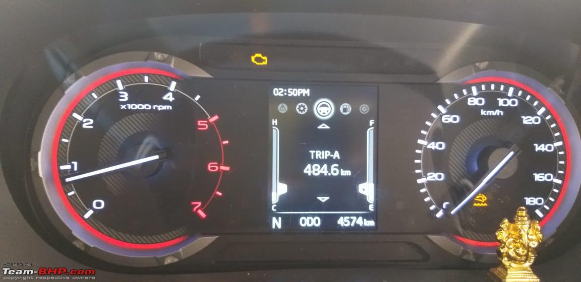

Anyone faced this error? 'DEF Dosing malfunction error - E22' and any known resolution? a friend who has one of the first deliveries from BLR is facing this issue.
Attachment 2125280
Attachment 2125281
The manual mentions dosing malfunction error has many stages. Did your friend see the first few stages before current error. The manual says contact dealer to get it fixed. No personal experience hence just shared what I got in the manual.
Attachment 2125280
Attachment 2125281
Either the Adblue (Diesel Exhaust Fluid) is running low or it is a malfunctioning Nox Sensor.
Solution is either a simple DEF top up or a Nox sensor replacement.
Attachment 2125284
They say Four stages and there are Five!
Happens randomly and this time it is intermittently coming and going off.
18 liter was found last time in the tank, so it is not low DEF.
Original dealer folks asked if the vehicle had done offroad or water wading and could not really find a solution. Now have referred to Mahindra through another good friend who is in charge of another workshop. Let us see what they respond back with.

Can be anything, probably electrical. Loose connection, sensor, adblue pump, adblue injector. Sitting remotely my guess is probably wilder than yours.
Jaggu I was given to understand from an insider in a Bangalore dealership this is one of signals of a "wiring harness issue" - goes away once the "new harness' is put in
Dont know how accurate this is

I got my LX CT Diesel on Saturday - after a drive of about 150 kms - the vehicle went into Limp mode
The dealer picked up the vehicle from my house on monday. Error code shown on the diagnostics was related to the injectors -
They have been advised by Mahindra to change the wiring harness. Its not in stock and they will do so once they get it in stock or at first service.
