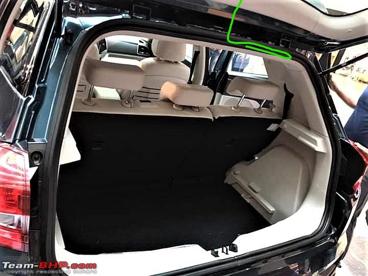

Hi Ashish,
A few questions on this dashcam wiring. I have got a Viofo A129 and was planning to hook it up myself. Would be great if you can share insights!
  1. Can you tell me how the wiring was taken internally Especially around the A-pillars which have the airbags.
  2. For the rear camera is routing best done via the door sill or via the rooflining?
  3. How did you route the cable to the rear camera finally around the boot door? Did you leave the wire open with slack or routed it through cable sleeve?
  4. Can you tell me what's the type of fuse we have in XUV3OO?

Originally Posted by krishnakumar View Post
Hi Ashish,
Thanks in advance!
  • So I checked the manual for details on the airbags, and it seems like they are installed at the very top of the door sills. So the wiring was done at the bottom edge of door sills. The installing guys assured me that this wouldn't be a hindrance to the airbag itself.
  • Also it was then that I discovered the "Airbag" placards on the pillars don't actually have airbags inside, but are place-holders/markers that hold a screw for the liner.
  • I considered the roof-lining, but it would've been an equal hassle what with the sunroof up top.
  • Above all this, the airbags are designed to burst open by breaking through the entire lining on that side. I hardly think a wire is going to stop that.
  • The wire is open with some slack. There is some spare wire spooled around near the fuse box.
  • As for the boot door, the wire was routed at the very center of the rear roof lining, and a small piece of wire left exposed in order to allow for expansion when the boot door is opened.
  • Not sure what you mean by fuse type?
Thanks Ashish!
While routing through the bottom edge of the door sill, how did you finally take it up to the roof in the boot? Was it taken to the top via the c-pillar? I wasn't sure on how to get this done and hence considered the top edge (what I meant by the roofliner). You're right that the wiring itself will not stop the airbag since it can punch through the tight fitting plastics itself
If possible, could you please share pictures of the wiring job if you had taken them while fitting?
Name:  Inkedthequint_201901_3f97464be9194dd4b4b020b8f56e06fd_WhatsApp_Image_2019_01_26_at_21_29_54_LI.jpg
This is how it is roughly done. The wire comes through the pillar, all the way to the center of the roof lining at the very rear end. And from the edge of there, a small piece of hanging/extended wire to the boot lid where the camera is attached.
