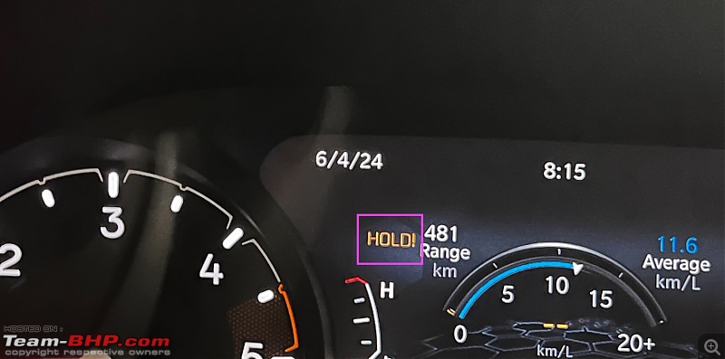

Dear Jeepers, I got a orange message that says "HOLD!" on the jeep dashboard today. I had not seen this before. I did look up the copy of my manual but it does not talk about it. Mine is 2021 Jeep 4x4 Auto. Has anybody seen this before and any clue as to how serious this is?
Jeep Compass : Official Review-jeephold.jpg
-Sameer.

Failure of Auto Hold function. A trip to the service centre may be in order. Might be as simple as the brakes needing service or something more serious than this.

Battery. You might need to change your battery. That’s what happened with me.
Thanks for the pointer both of you.
Only 14K Km and just above 2 years of use. It's unfortunate what quality controls are put in place these days. For by 2006 getz, I never had to change the battey in my 8.5 years of ownership (88K Kms). Next, with Yeti, changed it after 6 years (50K Kms) . And now this. It's just sad than state than anything else.
-Sameer.
-Sameer.
Batteries usually lasts for 3-4 years depending on the usage. Anything more than 5 years is unlikely and your were lucky in previous cars. Now a days there is so much electronics in modern cars, it puts additional load on the battery.
Aviator_guy is online now   (3) Thanks
