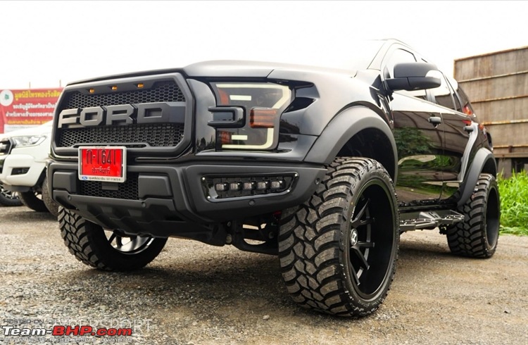

Ford Endeavour with a Ford F-150 Raptor Body Kit
Ford Endeavour : Official Review-endy-1.jpeg
Ford Endeavour : Official Review-endy-2.jpeg
Ford Endeavour : Official Review-endy-3.jpeg
Source: Indian Autos Blog
