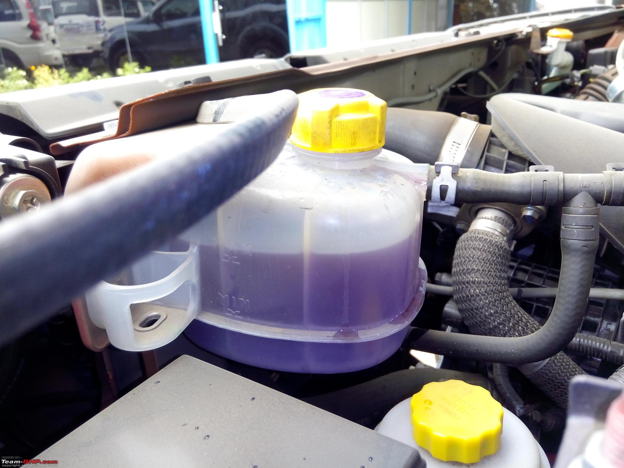

Even I am planning to get the coolant top-up done in the next few days as I have an outstation trip lined up over this weekend. The last time when I unscrewed the coolant reservoir cap, I found it to be loose. Hence want to confirm the hypothesis that if the coolant consumption is really high for the TUV or if the coolant has spilled/evaporated due to the loose cap.
Today while coming to office I went to Kundan Motors (Mahindra Authorized Service Centre in Chinchwad). I had already called up the Service Advisor & informed him that I am coming there for coolant top-up. On reaching there I showed him the level. He asked me if there is any coolant leakage. Since my parking floor was clean I replied in negative. Since the engine was hot he waited for some time before opening the reservoir cap. On opening the cap the trapped vapors were released and the coolant level rose up by 5-6 mm, it seems when the engine is hot the pressurized coolant vapors push the level down. However it was just at the "Min" mark even after opening the cap. The mechanic then brought a 1 litre premixed coolant can & poured it in the reservoir to bring it at the "Max" level. Here are some pics
Coolant just above "Min" level
Mahindra TUV300 : Official Review-img_20160518_100011.jpg
The one litre Maximile can (MRP was Rs 245/-)
Mahindra TUV300 : Official Review-img_20160518_100551.jpg
Level after the top-up
Mahindra TUV300 : Official Review-img_20160518_100618.jpg
I will observing the coolant level especially before and after the 500 km+ trip planned over this weekend and share the observations.
Edit: I forgot to mention, this top-up was a 10 mins job and neither any job card prepared nor I was charged a penny. The SA mentioned that during the initial period the coolant is consumed to some extent and hence the drop in level
Good to note. Would this be the case across or an act of generosity from your SA?
Why would this be the case? What is the initial period, and when does it cease to be one?
I would call it customer responsiveness. From what I have learnt from the experience of many owners here on TBHP, M&M acts very swiftly if the customer comes up with any complaint on a newly launched car. So any TUV owners coming with a complaint of low coolant level should get addressed promptly and this "act of generosity" should be uniform all across
Well that was his part of my Service Advisor's story, which obviously I did not completely buy in. I could easily spot traces of coolant evaporating and passing through the reservoir cap. Ideally it being a closed circuit, whatever coolant evaporates due to excessive heating should condense back in the reservoir/circuit. If there are no leakages in the system and the reservoir cap is fairly tight, there should be hardly any noticeable difference in coolant level after 10 kms or 10,000 kms running.
