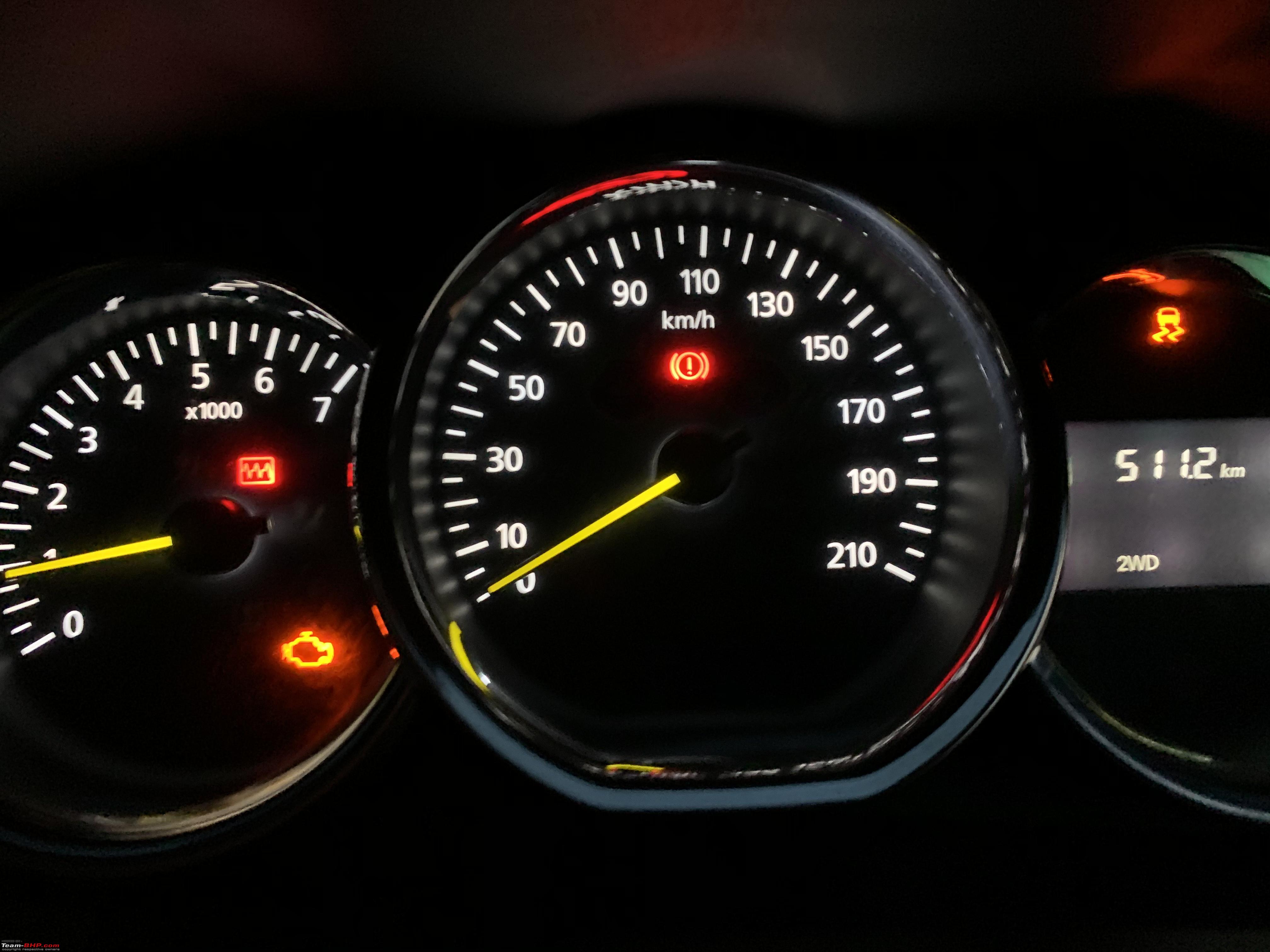

Seems like an injector failure to me!
The same lights were on, when the the injectors gave up in my Duster. Plus the symptoms were same too. Engine sounded coarse and it was jerky.
Sharing the pic-
Attachment 2044810
Agreed - either an injector or fuel pump, considering the kms run. I had the same symptoms for fuel pump failure. If you are lucky, it might self heal if the debris is cleared automatically (happened with @PapaBravo).
It could also be a leak in the intercooler hose. I got these warning lights and had to change the intercooler hose which costed Rs. 16,800 at the Service Centre.
