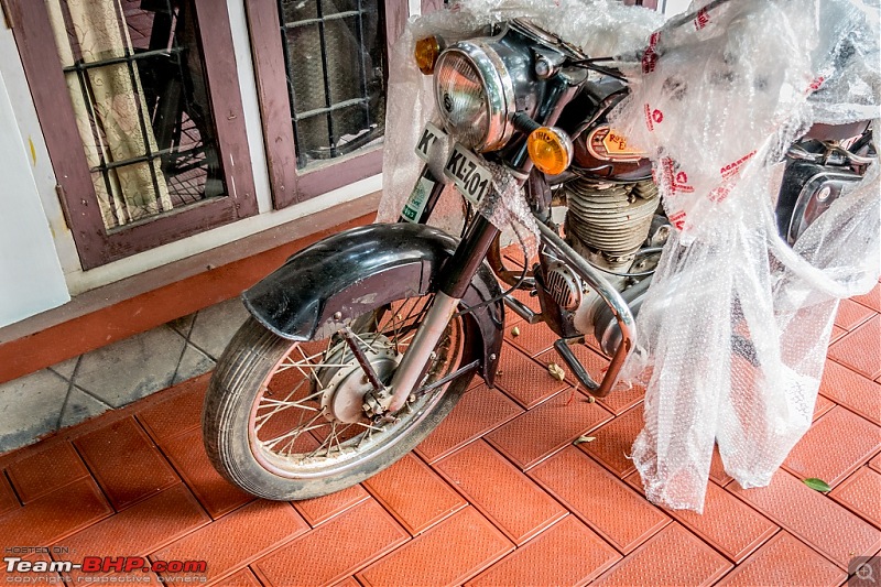

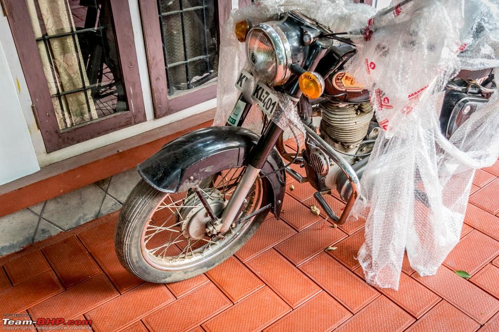

Although not a bike enthusiast, here's what landed couple of weeks back - 1970 model Enfield. A lot of work to be done especially the rust.

Whoa nice find, is it yours? Could you post a few pics of the rear? Looks in okish nick for a 45 year old motorcycle
Are you planning to do the work in Cochin?

Father in law's bike now used by my brother in law in Mumbai. Sent it here since he was not using it and moreover have some paper renewals to be done. It should be here from now on. I am actually planning to get the work done and might use it but have plans on bringing down a RX135 from Bangalore later this month. I have heard about a shop in Kacheripady who seems to be an expert in Enfield. Any pointers would be helpful.
Shall take some pictures tonight.

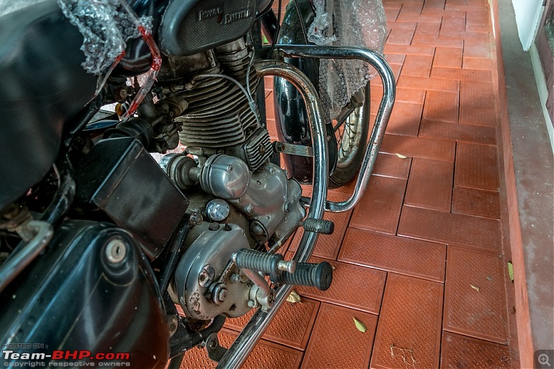

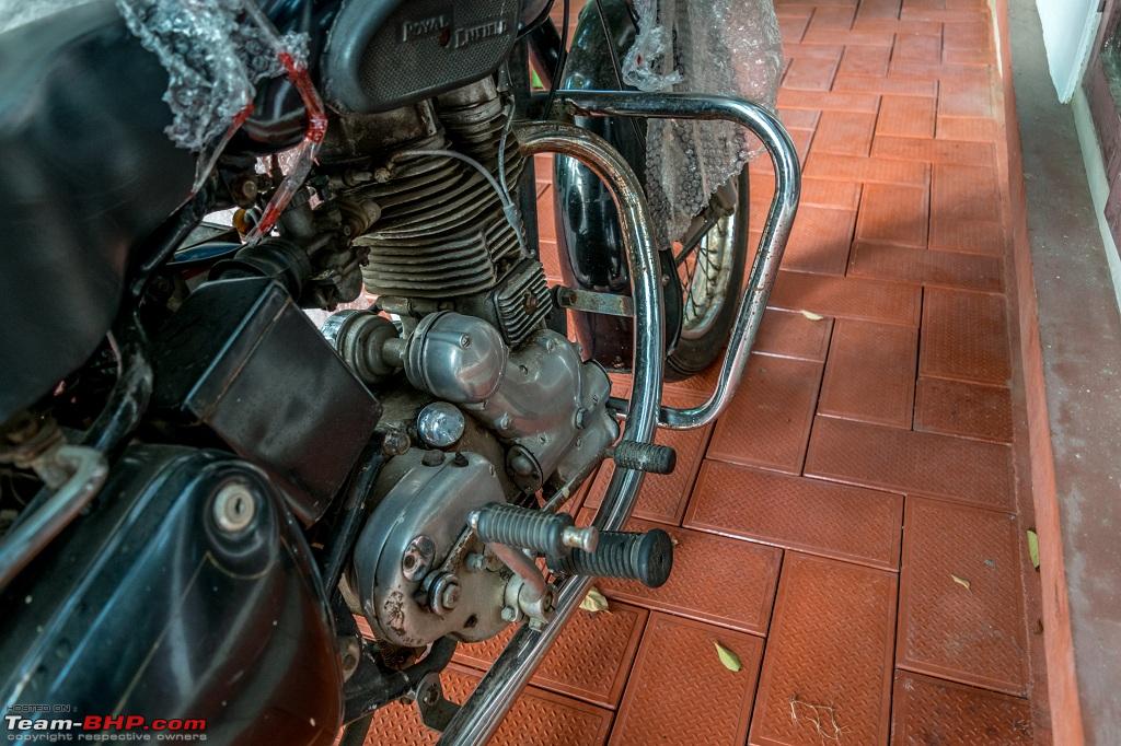

Here are some pictures.

It looks pretty okish, hows it to ride? Pm me if you need any help. I'd be more than happy to help out.
In my opinion, first order of business should be to get it in perfect running order, then take care of the cosmetics. Good to see that the original front mudguard is retained, Not too sure about the rear though.

I havent take it out for a spin. The clutch lever is broken . I will definitely need your help. Will get in touch with you once I find time to work on it.
