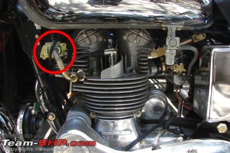

Could someone please tell me what this part (encirled in red) does. This is an AVL engine, one end of this component is connected to the carburetor & other goes into the cylinder head. I don't know what it's called & searching generically on Google isn't really getting me anywhere.
Thanks & Warm Regards

That is a the PAV (Pulsed Air Valve).
It provides pulsed blasts of air into the exhaust just outside the exhaust valve to burn any fuel that didn't burn in the combustion chamber.
The PAV system is intended to reduce emissions from the engine.
The hose running to the carburetor provides the signal for the valve to inject the air.
