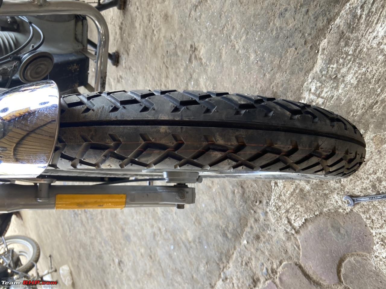

In anticipation of an upcoming ride, I have been desperately searching for Michelins. After looking everywhere with no result, atlast took the risk of ordering from Amazon (CloudTail). Was disappointed when I got 2018 stock - August for rear and December for front. Never the less the items are non-returnable so got it fixed on my bike today.
My old setup was Michelin in rear and Ceat in the front. This time it is Michelin both ways. Excited to test this out on a long ride.
Here are some pics:
The package that brought a temporary smile to my face today. Vanished after finding the manufacturing week and year.
All four tyres (old and new ones) together
Bike’s new shoes
warrioraks is offline   (1) Thanks
Congratulations on the new rubber.
How does the front feel after putting in the new tires? Does the tire still faithfully follow all undulations on the road, like a loyal dog following its owner?
That is one major issue I've felt with the front laterally striped factory tires, especially in roads that are going through re-taring. The bike decides it'll follow that small ridge and ride it until it ends. Getting out feels like it'll imbalance the bike as well.
That, and quite a lack of grip during braking/wet weather. However, I'm in Chennai where rain has hit quite sparsely this year, and use the back brakes most of the time. I'm going to be on the lookout for new Michelin's for the front, and will be getting them as soon as I can find one in offline stores.
Thank you DeathPig. I went for a short ride yesterday (~300 km) and found the grip to be better than the CEAT + Michelin combo I had earlier.
Did not fully understand the ridge thing that you mentioned but my initial feedback is that having Michelin both in front and rear is absolutely worth it.
If I had to nit-pick, then would say that with Michelin in the front, the space between fender and tyre seems to be reduced now. Maybe the 3.25 tyre from Michelin is wider than the Ceat one. But no issues faced till now.
Did you get a 2020 stock of Ceat Milaze? The tyre has great online reviews and I was seriously considering those before going back to Michelins.
