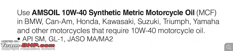

Wrong AMS oil used by many in social media is Metric oil which has only API SM certification which is for motorcycles and cars made before the year 2010. That's right, the certification is 14 years old as of this writing this post. Attaching pictures of the wrong oil for Himalayan 450:

I don't know if the incorrect metric oil may cause harm or not. It's just a caution to potential buyers looking to buy the AMS oil for their Himalayan. Buy the 4T performance oil and not the more expensive metric oil.
