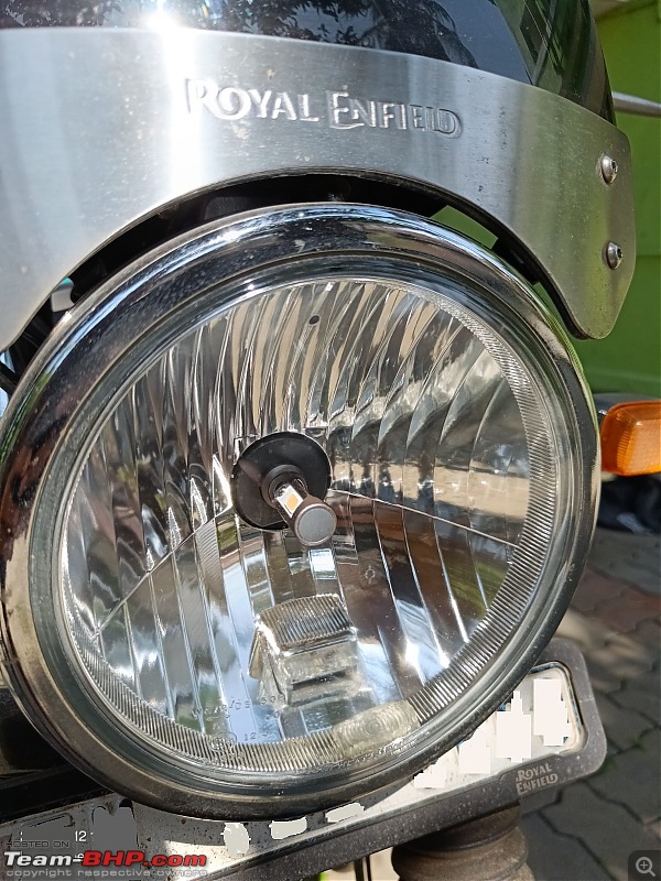

Ideally this post ought to have appeared in the very beginning, but, then, better than never isn't it?
One of the first upgrade that was carried out even before the seat mod was upgrading to LED. Thankfully the Downtown Drag was sold with clear headlamps & even before taking the bikes delivery, I had learnt to swap the bulbs.
Got in touch through Whatsapp & Autobahn shared the product link for Interceptor to be very sure that its a 100% fit. They were quite responsive (not the rapid fire response); once the bike was delivered, swapped the stock 55W Halogen bulb for 36W H4 LED from Autobahn.
No adjustment required, except for a minor job to cut the dust cover dia to insert the LED. This video should help to get the job done 100%; one caveat is that, he doesn't show you how to cut the dust cap. What needs to be done is, invert (inside out) the rubber dust cap & then you'll find it easy to chisel out the protrusion to fit the LED H4 bulb
I must say, the headlight throw is much satisfactory not just because the lumen output is significantly better than Halogen or consumes 19W lesser, but, the low beam throw is visually right enough for speeds up to 80 Kmph & hopefully it isn't blinding the oncoming traffic which I'm bound to check some other day.
Check if you are able to get a clean sharp cut-off line in the low beam. If it is not there then definitely you are blinding the oncoming traffic.
Do i see the small DRL broken or is it the camera view. I had a similar issue in my Himalayan and got the ASS to change it. They were of the opinion that using a powerfull bulb can cause the damage. Do check it out.

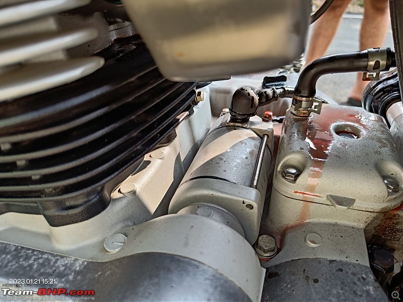

Service at 9202
Went to ASC on 11-Jan, asked if they could service the bike on 13-Jan, but will do a wait & take; although a little reluctant, they said they can oblige it by 18-Jan; called the technician, asked when would it be possible for them to tend comfortably & they said 21-Jan. On 20-Jan, got a reminder call from ASC requesting to confirm my visit at 9:00 Am & I said Yes.

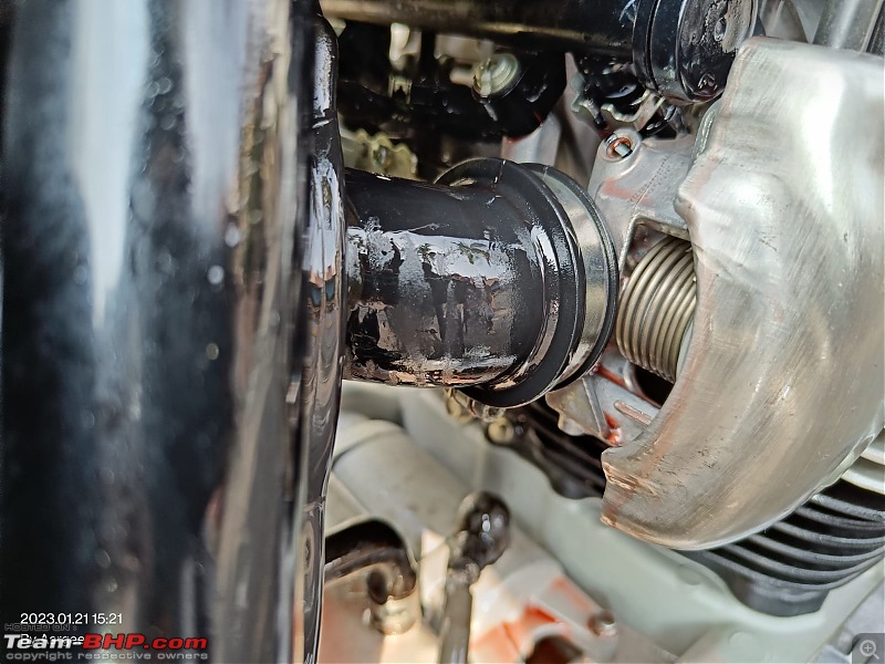

After parking this came as a little shocker:
Intercepting the Drag to Downtown | My Royal Enfield Interceptor 650 Ownership Review-1c7fc79d80e04b228b267c4e97a6733b.jpg
And the first thing to pop in mind was whether ASC forgot to shut the fuel cap like this incident as RE ASC are notoriously full & technicians are under pressure to meet their daily targets. But on closer observation the oil level hasn't come down significantly. Which means, the spillage is not more than 50-75 ml or so + the oil level indicates that the bike can still be ridden.
Intercepting the Drag to Downtown | My Royal Enfield Interceptor 650 Ownership Review-97e21eb9439744f59e1a10e25768e52a.jpg
Seems like the motorcycle is bleeding blood
Intercepting the Drag to Downtown | My Royal Enfield Interceptor 650 Ownership Review-7c72cb371f314214b2bf0cdd1319f637.jpg
Intercepting the Drag to Downtown | My Royal Enfield Interceptor 650 Ownership Review-10271a370ef84335a02702478cc3b56d.jpg
Intercepting the Drag to Downtown | My Royal Enfield Interceptor 650 Ownership Review-13736cd45fbf40e695cc8b1e246e2d1e.jpg
Intercepting the Drag to Downtown | My Royal Enfield Interceptor 650 Ownership Review-26281d71882346208b2d7608a196729d.jpg
Intercepting the Drag to Downtown | My Royal Enfield Interceptor 650 Ownership Review-b9770fb68f4a40b6942e4d9b4d3b6c25.jpg
Intercepting the Drag to Downtown | My Royal Enfield Interceptor 650 Ownership Review-dd90d2ed500a46a0bc5aa370e8b22818.jpg
Rode back the bike to ASC immediately, told them the 3 issues on brakes, difficult engaging second gear & the oil spillage; technician immediately recognized the issue & attributed the oil spillage to O-Rings at cylinder head. He said it's perhaps due to the valve adjustment that was carried out. During that 5 minutes this was the loss of oil
Intercepting the Drag to Downtown | My Royal Enfield Interceptor 650 Ownership Review-d81afb1c9e804c44a6aaf373e29afbb1.jpg
The gear issue was fixed by adjusting the Gear Shift Linkage; Gear position indicator sensor was replaced under warranty for fixing the Neutral light issue.
Brakes have lost that sharpness, but I think its primarily due to air bubbles within the steel braided lines; hopefully I can fix it in the forthcoming days. Tappet noise? I'm still nervous to hand over to ASC for fixing it!!
Due to such reasons, it always scares me to drop my bike at RE Service! They're talented enough to mess up a simple job.
I didn't get which O rings are referred here, is it the cylinder head rubber gasket? No other seal is supposed to be touched/removed in the valve adjustment process.
In addition, if valve adjustments were carried out, then why tappet noise is present?
Asking for all 650 owners so that we can be careful during our RE-service!
This is the bill; I think it's the second item; I'm not convinced with their O-ring reply as well!! Plus I think the cylinder gasket (if at all replaced) ought to have sealant/silicone applied before placing the gasket & they're sure to have missed it as well!!
Intercepting the Drag to Downtown | My Royal Enfield Interceptor 650 Ownership Review-b1.jpg
I've the same question too, but, I'm in no mood to argue with them
