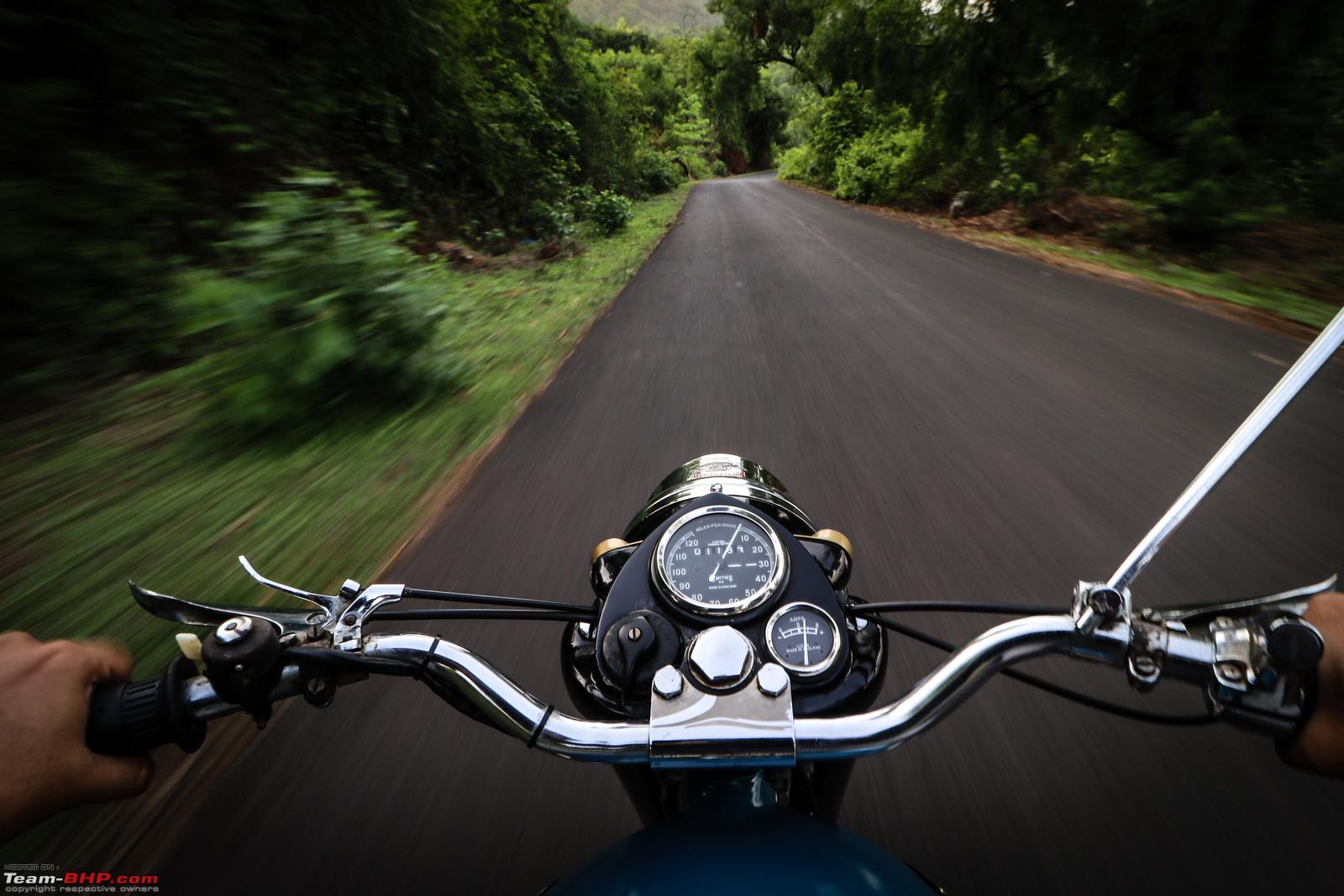

There is a knob next to the speedometer which has 3 positions. Off, pilot lamps (those 2 small lights above the headlight) and headlight.
You have to remove your hand from the handlebars to switch on the lights. The switch too as with other parts of the bike needs a bit of a firm hand.
