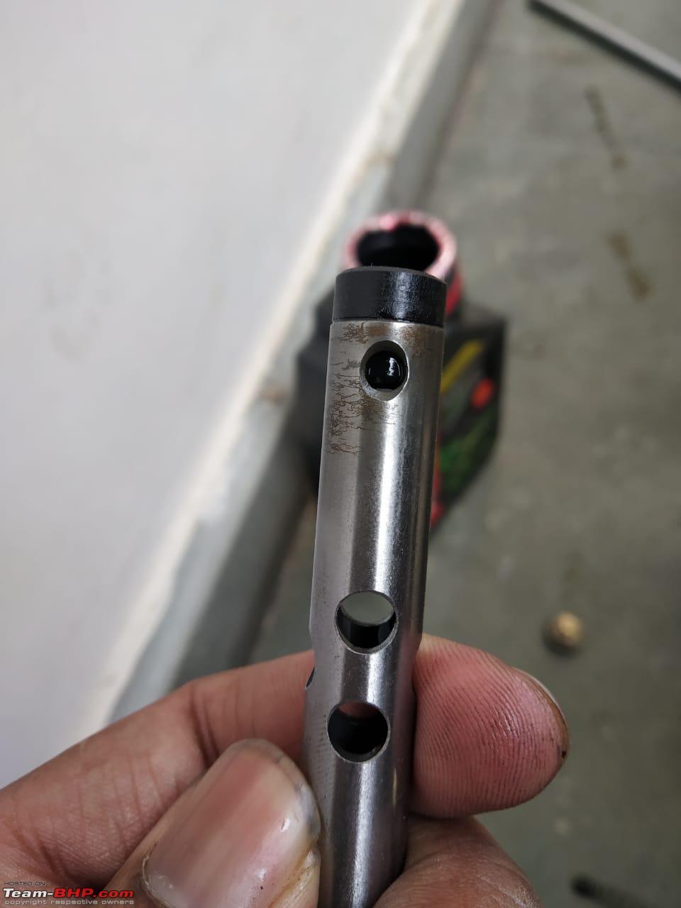

Hello Everyone,
In this lockdown period, today I tried firing up my Dad's Splendor. What i found was quite shocking. After starting there was some tik-tik noise from the magnet cover, which after the engine warmed up vanished. I believe that this was indeed the crank noise. The bike was regularly serviced but till date the centrifugal filter nor the oil filter has been cleaned, neither have the valves been adjusted. It has done around 47,000 kms till date and is 17 years old. Now that noise from crank has really got me worried. I wonder if there is any problem. But maybe it was due to the fact that the bike was standing on the side stand for quite a while and all the oil drained out from the bearings. Second reason I suspect is the oil. Hero Honda used to recommend 20w40 for this engine back in the days but these service centers irrespective of the model year have used 10w30 in all bikes.Could this lead to increases clearance in the crank due to enhanced wear and tear? I did the last oil change myself and poured in 10w40 Mobil Super Moto (Semi Synthetic).
Another concern was that there was noise from the timing chain which was present even when the engine warmed up. So decided to pull out the cam chain tensioner and see what's going on with that. To my surprise this is what I found
The rubber plug had this indent, whereas the tensioner itself had these cracks.
These cracks were not due to metal fatigue but it seemed like the top layer of the metal had eroded. Although the tensioner itself was fine and was holding the pressure nicely but still should I be replacing it?
After the spring was elongated and and placed back in the bike even then the cam chain noise didn't disappear. I'm guessing that the cam chain is now asking for a replacement. Also should I be replacing the oil pump gear since that is very much prone to failing on these bikes.
Thanks.
The timing chain tensioner is a rudimentary setup on the Splendor and rests behind the Magneto. You could manually inspect if something is out of whack, ideally this is supposed to be a fail-proof system.
Now coming to clatter that shows up when the engine is turned on but vanishes a short while after is usually the result of poor oil circulation and the first point of concern should be your oil pump, cause a weak oil pump takes time to send oil to the head which would result in clatter that would go away after warming up.
Crank noise doesn't go away like that, be it crank bearing howling or piston slap.
Plus on a half decently maintained machine the crank would last 100k km's at the least before acting up.
If there is no clatter from the valves feel free to ignore, my P220's valves haven't been adjusted since purchase and she has clocked about 50~60k km's now.
As for the Centrifugal filter, the one on the commuter Honda and Kawasaki's are huge, would take more than 50k km's before it gets clogged.
Here's a picture of the rotor on a friends Splendor, the motorcycle had IIRC 60~70k km's and we'd opened her up a day before an interstate run to change the clutch plates, the rotor filter was perfectly clean.
My friend was the one taking photos and he didn't know what to snap, hence do not have a picture of the inside, but trust me it was clean.
As for the strainer, it would ideally be clean provided oil changes are religiously performed.
Not a matter of concern, these machines are heirlooms handed over from generation to generation, 50k km's is just scratching the surface.
The Oil Pump is what feeds the bearings oil, so if it is working fine then you shouldn't worry about oil pooling etc, as it sucks oil from the base of the case i.e where the strainer is.
You can use any oil you want provided you do not extend drain intervals, using 10W30 instead of 20W40 wouldn't hamper engine life drastically, my CT100B is recommended to run on 10W30, I've been running 20W50/15W40 without a care in the world and its not even motorcycle oil.
So basically, change interval makes all the difference.
If you're 100% sure its the timing chain then replace the timing chain kit along with the tensioner kit to give you peace of mind, which case change the oil pump as well.
If possible take the head and cylinder off and inspect for play on the con-rod, just jerk the piston up an down, if there is movement with the crank remaining stationary then you have play, though if at all there was play you'd be getting piston slap.
Since you're taking the head off do change the piston rings as well.
All this is not needed, but ideally if I take the effort to open anything I make sure everything consumable component in the vicinity is also replaced as it'd prevent the need to get my hands dirty in short succession.
A.P.

I doubt revving the engine cold would cause such aggravated wear and tear, especially on this engine.
After all this 'sloper' engine was built by Honda to account for such kind of use, one of the intent of sticking with the sloper design was to ensure that the top end was lubricated as soon as the motor was fired up by negating gravity from the equation.
I recall reading that on the original motor big daddy Honda wanted the engine to survive poor maintenance of the worst kind seen in rural Asia, the engine surviving extended drain intervals was one of his requirements and a reason why I believe these motors have humongous centrifugal filters.
I'm also guessing Kawasaki borrowed the design philosophy with the 4S Champion cause other than the Honda derived motors and the Kawasaki 100's used by Bajaj I've not seen any other motorcycle sport such a huge rotor filter.
Rotor Filter on my P220 for comparison:
I was used to these robust 200~250cc motorcycles and the first time I saw my CT100's rotor filter I was in for a surprise.
Cheers,
A.P.
