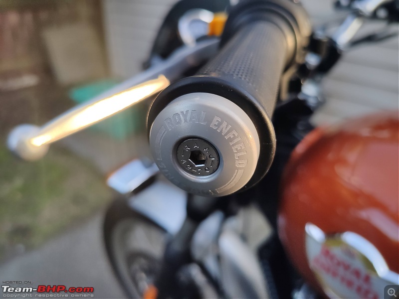

Fitted a couple of bits and bobs on the bike last weekend. The local dealer was not sure how long it would take to get these parts. With help from my father, I sourced these from India though it took a good 8 weeks to get here. International post is a hit or miss. The post office had not idea where the consignment was and tracking has hopeless. Compare that to Fed Ex, I ordered Trip Machine's military bag and it reached New Zealand in <7 days!
What you see in pictures are the bar end finisher and the oil filler cap. They are purely cosmetic upgrades.
