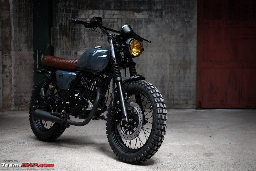

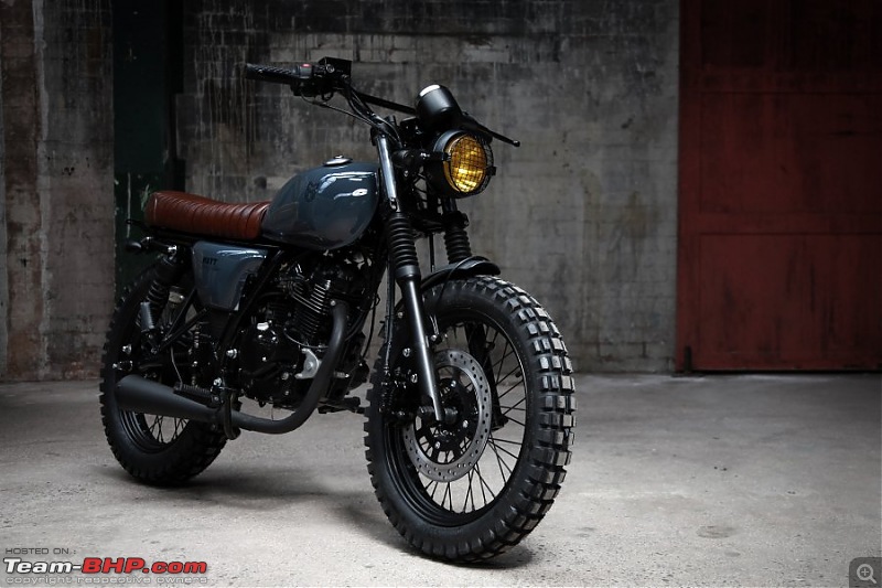

Whats your take on coverting Rx 100 to Mutt bike like the one attached? Are you a purist?
