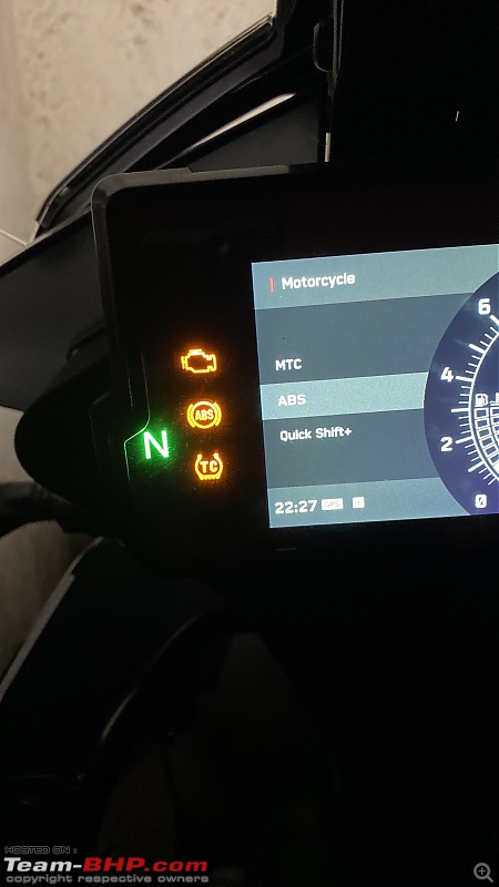

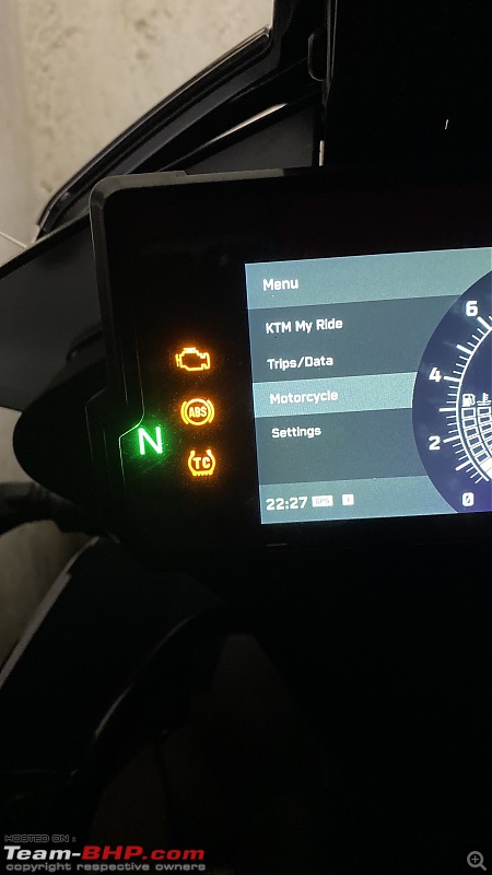

Hello! Have a few questions.
1. How to adjust the headlight beam? It's currently pointed towards the sky
2. Anyone experienced a sudden hiccup during riding? As in a loss of power for a second. Happens randomly. Not just while up or down shifting.
3. I cannot find the quick shifter in the menu anywhere. Is it enabled only after first service?
2- disable quick shifter under menu, I had the same issue when I had it enabled in first gear. Abrupt engine cut off. Once I switched off the quick shifter, this issue also has gone.
3- motorcycle, along with abs and mtc. But I guess the updates software has this disabled, for run in I guess.
