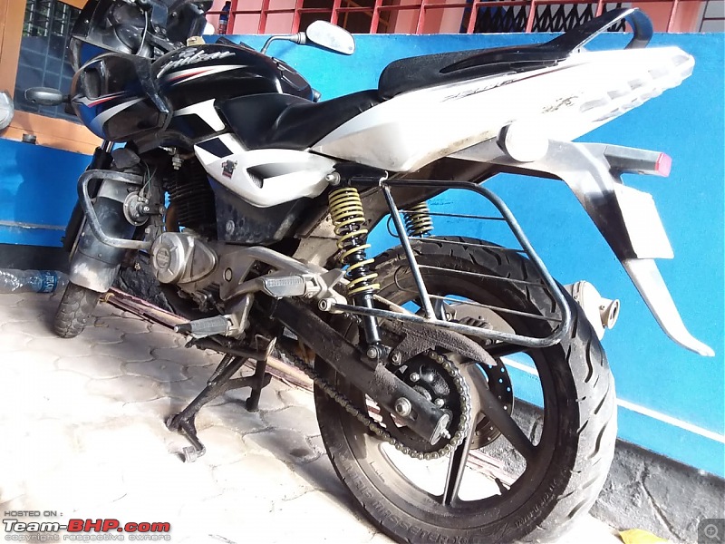

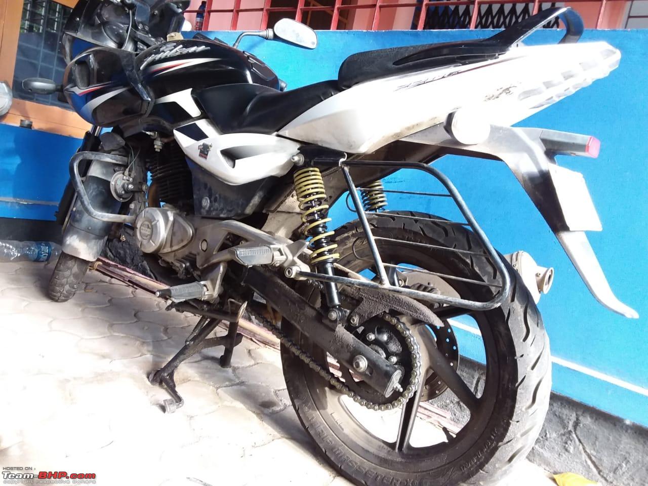

Boredom did get the better of me and I did install the rear sprocket and chain of the XCD125 kit, with stock suspension you need to remove 10 links from the chain and bring it to 112 Links i.e Stock Number not 114 Links as per the Platina 125's kit.
I mentioned stock suspension cause I'd swapped out my stock shocks for the ones that were installed in my P220 i.e the Pulsar 135 Shocks.
Though quite taller than stock I had no concerns with using the main stand, which was a surprise as on the P220 the main stand didn't even touch the ground.
A point to note is that the CT100B has larger sleeves(17mm) than the Pulsar(12mm) at the bottom mount i.e swing-arm mount which I'm presuming is due to its heavy-duty nature of use. Here's the sleeve on the CT100B(Same at Both ends i.e Top and Bottom);
Bajaj CT100B - Utilitarianism Redefined!-whatsapp-image-20200520-7.48.15-pm.jpeg
And here's a snap of the Pulsar's bottom mount from an older pair of P220 shocks I had laying around;
Bajaj CT100B - Utilitarianism Redefined!-whatsapp-image-20200520-7.47.45-pm.jpeg
So basically I had to knock out the old sleeve from the P135's shock at the bottom mount and replace it with the stock larger sleeve on my CT100B's old shocks.
Also to note is that the taller the rear shock is, the shorter your wheelbase get's so the chain needs to be readjusted and I'm guessing I'd have to remove 2 more links, keeping it for next time or when the chain reaches maximum wear on the adjusters.
Having a Chain Breaker helps!:
Bajaj CT100B - Utilitarianism Redefined!-541fb7a99ad846d0a503a89af6396440_1.4bd36e3f3a0c0cf9ab61fa1e88ff5447.jpeg
Fortunately I was able to grab one from Amazon when they were selling it for around 500'ish a few years ago, now its scarce.

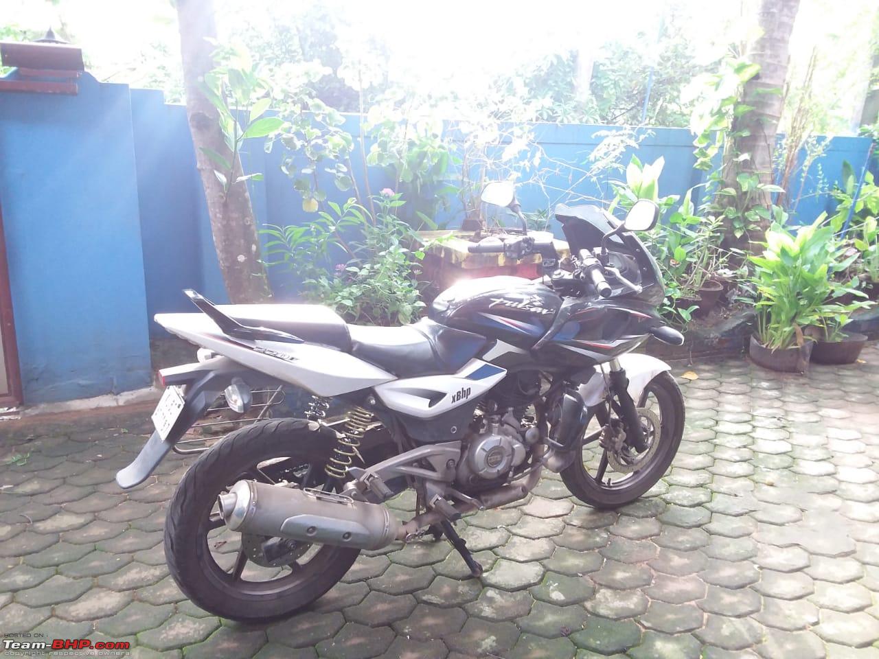

As for the P220, in the earlier pic you'd notice her in the background with an odd stance, that's cause she had no shockers due to a delay in procuring replacements;
With the help of Sarathy Bajaj, Kollam, I'd sourced and installed Comfortec shocks, they cost about Rs.1500/- a pair, they're roughly an inch taller than stock and hence makes sure that the main-stand works as well, something which was pestering me when I had the P135 shocks on, which were 2 inches taller than stock.
Bajaj CT100B - Utilitarianism Redefined!-whatsapp-image-20200519-4.56.58-pm-2.jpeg
Bajaj CT100B - Utilitarianism Redefined!-whatsapp-image-20200519-4.56.58-pm-1.jpeg
Bajaj CT100B - Utilitarianism Redefined!-whatsapp-image-20200519-4.56.58-pm.jpeg

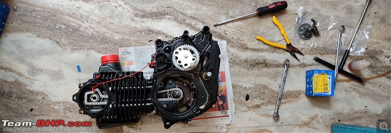

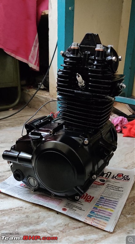

In the meanwhile a friend of mine has been rebuilding his fathers CT100 which had been defunct for a really long time;
Bajaj CT100B - Utilitarianism Redefined!-whatsapp-image-20200510-2.20.42-pm.jpeg
His workmanship is commendable as utmost care is being taken to produce better than factory fitment, other than the powder coating the rest of the work is carried out by himself, other than the gearbox, cases and head, everything is brand new.
Bajaj CT100B - Utilitarianism Redefined!-whatsapp-image-20200502-5.32.25-pm.jpeg
Bajaj CT100B - Utilitarianism Redefined!-whatsapp-image-20200506-8.33.42-pm.jpeg
The lock-down did makes procuring parts difficult but it also did give him quite a bit of spare time to experiment, the result of which is seen below;
