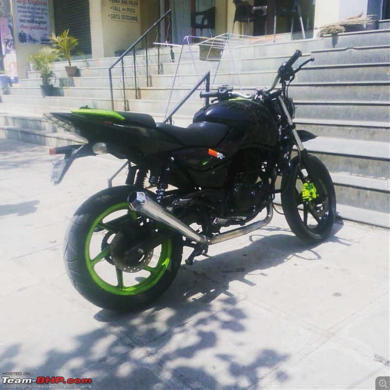

My Bajaj Pulsar 220 DTS-i : 7 years of ownership, experiments & ride-break-fix-repeat
It's been almost 6 months since she was doing well. I am in a process of getting her back to life once again, and to speed things up I thought of writing about her while at it. I refer to my bike as 'she' and I do greet her mornings and nights and appreciate her while on the road. This thread was long due. So here it goes.

The Bajaj servicing centre at Balgandharva was really lacking the quality of service and I was looking for a new mechanic. I was never into this might void the warranty thing and it had ended anyway. A friend directed me to his mechanic who used to work at the then famous BG workshop on weekdays and elsewhere on his own on weekends. Booked a day with him when he was off work, discussed a lot about engines in general and he became a dear friend later. Things like putting NGK Iridium plugs and a K&N filter were done then and there as they were very basic things to do. I needed more and was not shy of experimenting so I asked him if he could do head porting . He was honest enough to accept that he knew the process but had not tried on a Pulsar 220. I too wanted to give this man a try and asked him to go ahead with it. A week later, we ported the cylinder head, polished it and replaced the jets with bigger ones. The result was a big grin on my face inside the helmet, and a bigger grin on his face because I let him do it on my bike. Most of his customers were the regular servicing ones who didn't like to fiddle with the engines and he was bent on the other side, wanting to do inside-the-engine stuff. The bike was running way better, the acceleration was quicker and me not being a fan of what's the top speed on this one didn't bother to check that.
Other things done in this span of time was replacing the carb (the float was giving a problem) with a new one that came from a 220S test bike, plonking the K&N on top of it (removed the hose and the air filter box setup, basic DIY) and welding the stock exhaust on its underside in an attempt to make it semi freeflow. Meanwhile, I wanted to get rid of the weight and hence she had no fairing mounted for a couple of months, only the headlight on the mount. All the wiring was exposed and hence was packed and stacked behind the headlight. All this drill was to come up with a different setup for the front. I was already in love with the reduced weight of the bike and wanted to keep it like that, but with a different and a better looking headlight. I couldn't come up with a good idea for two months and hence the fairing was put back on it. The rainy season was coming and putting the wiring harness at risk wasn't really something that I wanted to do.
The first block and piston lasted me a good 1,10,000kms. It may sound too good to be true, honestly, I wasn't expecting it to last this long. One reason being bajaj parts quality and the other being added stress on the engine. But then I had always had mandatory oil changes before their stated intervals. I had tried various oils before deciding to stick to Motul 5100 Semi-synth (she was at around 55,000 kms that time). Got them replaced and was thinking if the inlet and exhaust port on the head could be increased any further (if it wasn't already). Needless to say, got it done next week, also welded off the catalytic converter from the stock exhaust. Bigger grin again.
The fairing vibration had always been irritating all this while and I was fed up of the sound it was making. Finally took the decision to remove it again, this time with a fair idea of what I was going to do later. Firstly, we welded off the fairing mount from the bike (no going back to stock again). Being a fan of retro motorcycles (who isn't?), I had always loved round headlights however, I was not keen on putting aftermarket clear lens / old pulsar / other old bikes' headlights except one. The Yezdi Roadking headlight. Yes, it does sound, look, feel old. It also sounds like it is going to look out of place on a modern day pulsar. But still, I wanted it. And I wanted something that will keep the visibility in check. So we procured a Yezdi Roadking headlight and a car's Fog Light bulb. The fuse was old and gave away, replaced it with a new one and the bulb was working fine. Why a car's Fog Light bulb? Because I still had visibility problems using the 55w dual filament bulb (Avenger) given the unclear pattern on a Yezdi headlight. The light bulb was pretty useless at high beam but its throw and spread were excellent on low beam. This was nearly what I wanted since I didn't use the high beam much. Also I HATE WHITE LIGHTS, so I was clearly against going for one of those.
My Bajaj Pulsar 220 DTS-i : 7 years of ownership, experiments & ride-break-fix-repeat-2.jpg
My Bajaj Pulsar 220 DTS-i : 7 years of ownership, experiments & ride-break-fix-repeat-3.jpg
The paint - There isn't any issue regarding the stock paint so far. Still, wanted to add an extra color on the bike. I didn't want to overdo stuff, and once again I didn't want any professional to do it for me. So I went the DIY way and got 4 Bosny Fluorescent Yellow cans. Dismantled things that I wanted to paint and a dear friend started the process. Within no time, we ran out of paint and the shade wouldn't hold itself properly. Got some more cans, repainted, still not satisfied. By then, I had started to think that I could have gone with a different color base before spraying the fluorescent yellow directly (upon cleaning of parts). But I had ran out of time and had to leave for a long ride next day, so I had to leave it as it was to dry. This was a year ago, and she still has the same uneven shade on parts. Sad, I know. It is on my to-do list when I get her up to running condition soon.
My Bajaj Pulsar 220 DTS-i : 7 years of ownership, experiments & ride-break-fix-repeat-4.jpg
The handlebar - most pulsar owners face the issue of nut breaking inside the clip-on handlebars and my experience was no different. I was riding on a 20km offroad patch when the nut on the right side clip-on broke inside. I was doing around 40kmph and the right side handlebar just came off in my hands. Managed to stop the bike, tied the handlebar with a piece of cloth and went on. But, did I want to fix it or change it? I swapped it for a KTM handlebar. It was straight and much more comfortable on long rides. The only downside being the stock handlebar weights didn't fit on it, and I plastic handlebar weights are pretty much useless. That said, handlebar weights are on my to-do list too.
My Bajaj Pulsar 220 DTS-i : 7 years of ownership, experiments & ride-break-fix-repeat-7.jpg
The exhaust - had to go freeflow, but I wasn't keen on anything that was offered in the Indian market. Reason being quality issues and no calculations whatsoever. If you're reading this, a name might come to your mind (Joel). I did give it a thought but I didn't want her to be in a similar state of tune. Having ridden a Joel'd 220, I must say he's really good at work. However, I wanted her to be one-off experimental like she had always been and decided against it. Just another time when the love of retro motorcycles came into picture - I went with a megaphone exhaust. Yes, it has a better quality than local exhausts. Yes, it is made for Royal Enfield and not for Bajaj. Talk about retro looks. Also, talk about loudness. The megaphone was too loud on higher rpms but I never did higher rpms in the city and so I could live with it. Deciding on the megaphone exhaust was solely based on the way it would look on the bike and most calculations, changes were kept for later when she would break down (Note - I do not advise anyone to put a RE aftermarket exhaust on other bikes, it might look pleasant but it comes with its traits). So the megaphone was put on and I was happy looking at it, happier revving her on the highways. That thing really changed her nature. Also fuel economy was never in question but if it did cross your mind - I used to get a healthy 45kmpl in city and 50+ on highways. These figures have pretty much been the same for most of the ownership.
The suspension - Just another thing that's wrongly set up for satisfaction. Having ridden bigger bikes (mostly Benellis) for sometime, I started to feel that her height is too less (I'm 5'11" just in case). Every single time I used to jump off a 600GT or 600i, the feeling got amplified. Not that their seat height was very different from a 220 though. Having removed the clip-ons, the extra fork pipe that used to sit inside was utilized and the handling position was raised a bit. But I wanted some more overall and hence swapped the stock Endurance rear shocks for taller (>1.5" approx.) Endurance shocks. The feeling went away, and I was happy once again. Downside - Heavier front, zero offroading, added strain on the chassis. In short, not recommended. I had been sourcing bigger front fork tubes for quite sometime then, but I couldn't get my hands on a decent pair and so I stopped searching eventually. Have some calculations done and now, the solution lies in swapping the front forks for bigger WP USDs. I'll try to get them fixed as and when I have the time. The rear shocks will be swapped accordingly too, if required. Any suggestions on this would be helpful.
The tires - As I mentioned earlier, she had done wearing 2 front and 3 rear stock MRFs and the next set was due after sometime in Pune. My idea with tires has always been to use them until there's no lack of confidence and burn-swap them once they start losing grip. I have never calculated tire life in KMs but I can be sure of not using a rear tire for more than 15k kms on an average. I have managed to keep the front tire stock (size and manufacturer) till now and i swap it in a 2:3 ratio as compared to the rear. I haven't faced any issue with the front end till now however I am currently thinking if a 100/90-17 should do the duties in future. As for the rear, I tried everything available in market (stock size and 1 upsize post head porting) and settled with a PSD 130/80-17. The power delivery after head porting had the stock size rear going sideways on every up-shift past 6k rpm and so I settled with the 1 up-size eventually and have swapped it around 7 times now, until the recent tire change. The rear tire currently on the bike is a stock size Michelin and a horribly wrong decision. I had to change the rear tire just before a long ride and PSDs were out of stock. Had no option but to put the Michelin. Now I am thinking of changing it to stock size MRF Mogrip (great grip) since my bike will be used more on bad patches and lower rpms instead of highway stretches and higher rpms.
The end -
She's done around 1.5L kms in 7 years. I don't know the exact number since the speedometer wasn't there after the headlight mod. The chain sprocket set has been changed around 8 times and the stock rear brake assembly has been swapped for the new and better Bybre (around 4 years back). She's not in running condition since the past 6 months after the timing chain broke. I have had no time to work on that but I am planning to do it before 2017. I have been off two wheels for quite sometime now and I cannot wait to get back to it. Thank you for reading. Any suggestions on any part of the above story would really be helpful.
My Bajaj Pulsar 220 DTS-i : 7 years of ownership, experiments & ride-break-fix-repeat-5.jpg
