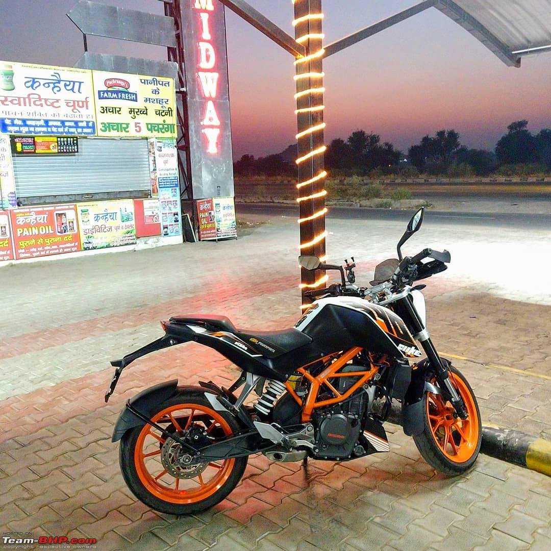

I own a Gen 1 Duke 390 from 2016 (And a gen 3, but that's for a different thread).
I'd like to know if anyone has tried fitting the wheels, brakes and/or suspension from the gen 3 Duke 390. What's your feedback on the same?
