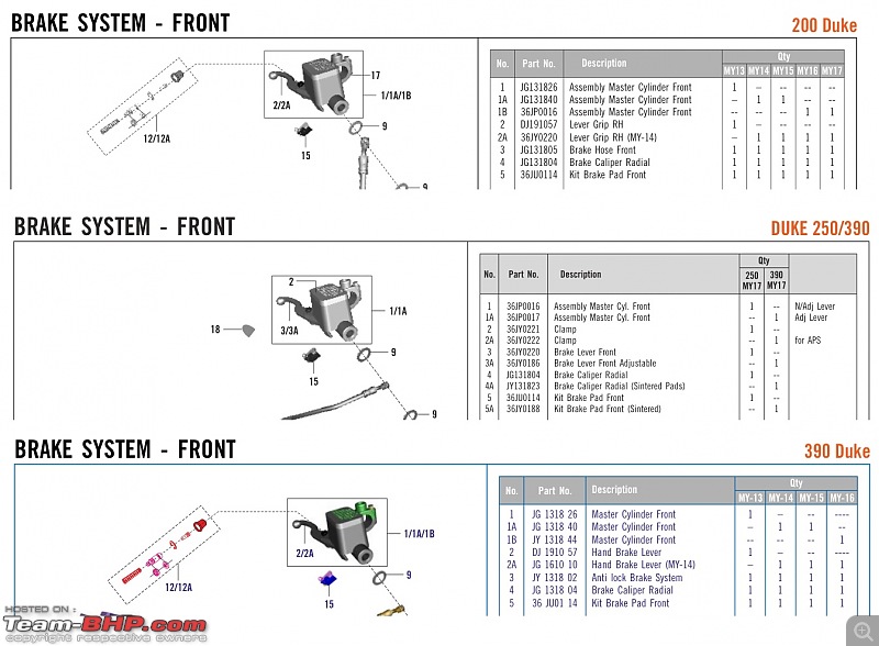

So this 250 MC is the same as the ones for the 200 as well as the 390, just that the 200 and 250 ones have normal levers, and the 390 ones are the ones that come with adjustable levets, as the ONLY difference?
Asking coz I have decent sized hands and adjustable levers are not a tjing for me. So I'm happy with normal levers, as long as Im not putting a 250 part on my 390, where the basic 390 part (the MC itself) is slightly different.
Yes, as per the spare part catalogs. Fun fact, the MC used on the 2013 D390 and 2012-13 D200 are the same as the pulsars. You can verify it from the part numbers. No wonder I said it was "horrible". Difference between the 200/250 and 390 MC seems to be only the adjustable lever.
