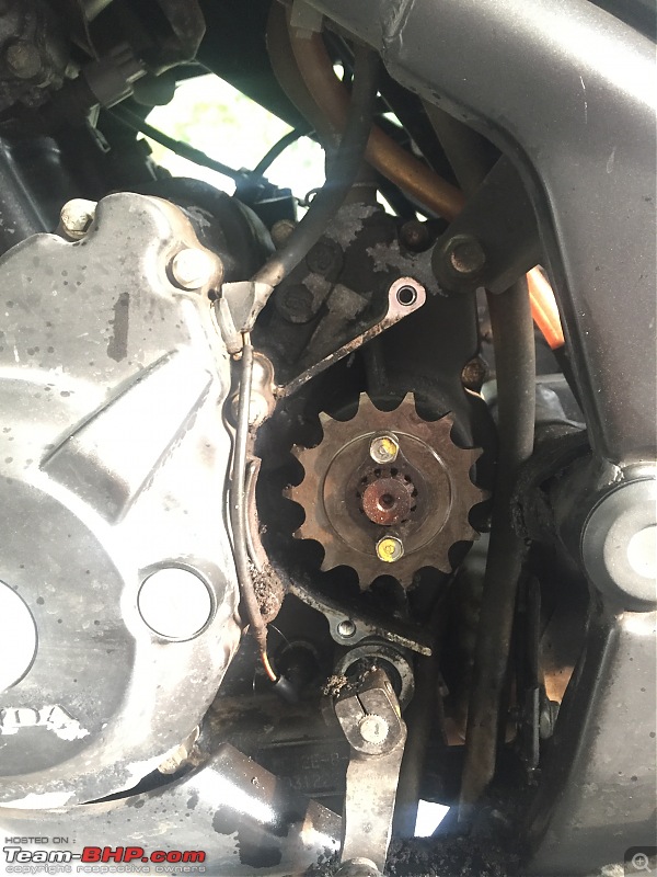

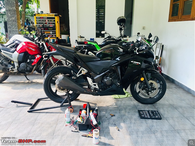

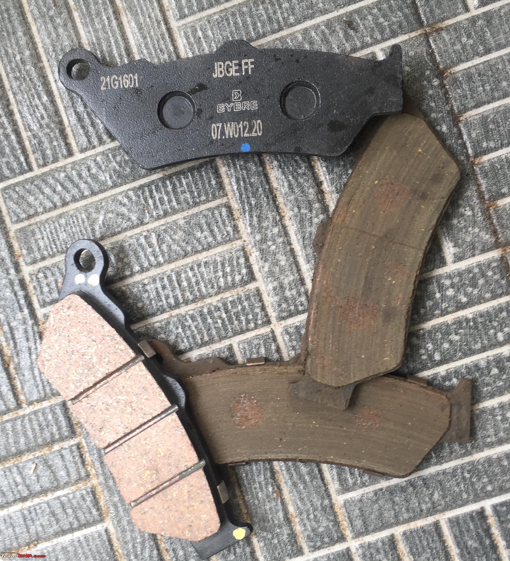

While getting the oil & filter changed two days ago by Sunjay of F Motors (Palluruthy, Kochi), also got the following done :
1) Front disc pads changed with OE pads. After 8 years & 23000kms, they were almost worn away.
2) Got the chain & sprockets replaced with RK Japan set. Can totally feel the difference.
This is the 2nd service I am getting done by Sunjay & I am totally impressed with his workmanship & attention to detail.
Thanks krishnaprasad for recommending him.
