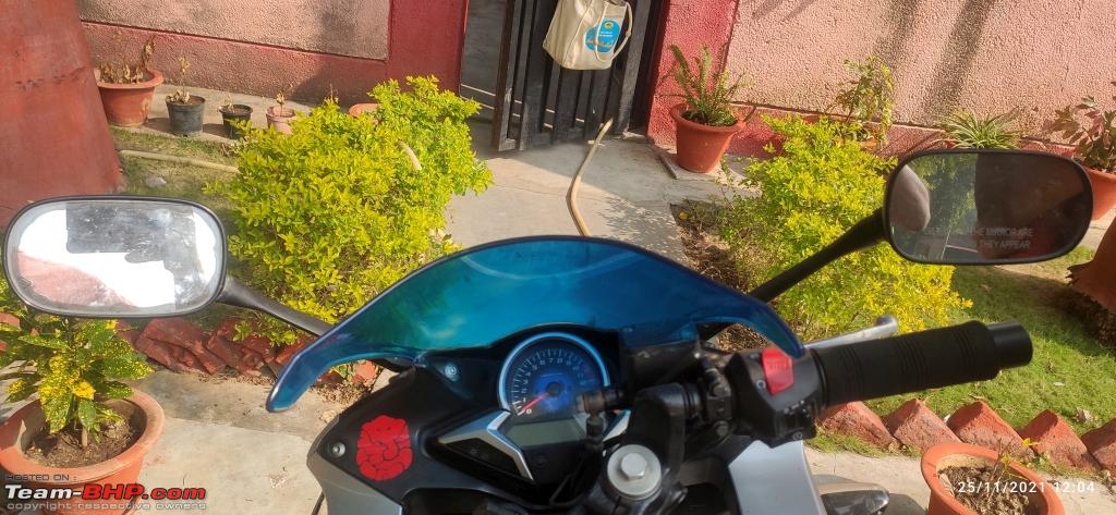

The left mirror was looking funny and the edges were blackening out. On close inspection, I found that the previous owner had replaced the mirror part with shaving mirror cut in the exact shape. My respect for the previous owner increased ten folds. Immediately ordered the mirror along with replacement bolts for handle and fairing clips from an online seller.
Honda CBR 250R : Answers to some commonly asked questions-mirror.jpg

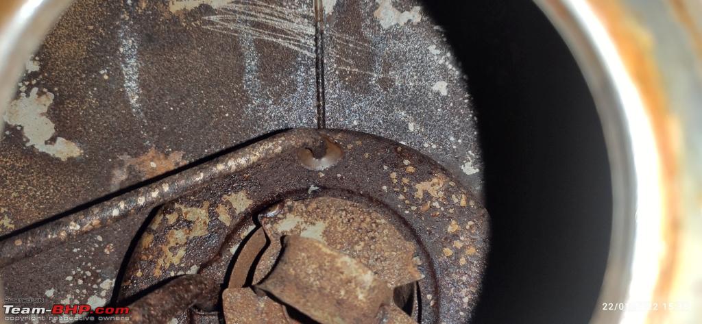

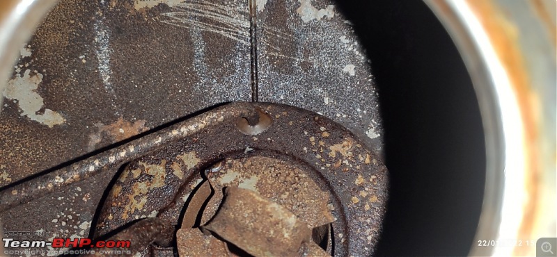

The fuel pump assembly had a lot of rust deposited inside. Cleaned everything using a brush and generous amount of WD40 and then replaced the fuel filter set .

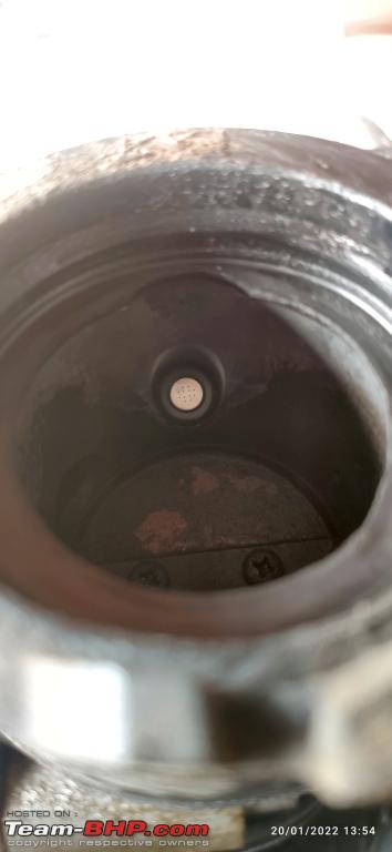

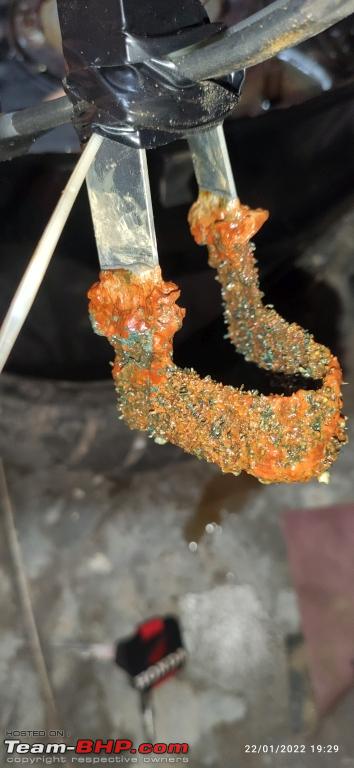

Got the tank a day after but I wasn’t satisfied with the amount of rust still left inside. Since I had one more day off, I thought why not to try rust removal by electrolysis. Went ahead and did it for the next 8-9hours.The results were better than pressure wash cleaning, but an exo dish wash bar commercial like output is not to be expected. Cleaned the tank a couple more times using compressed air and left it to dry overnight.
Honda CBR 250R : Answers to some commonly asked questions-tank-after.jpg

If you plan to continue using the OE tank, it would be better if you can get a epoxy coating done on the inside of the tank to prevent further rusting.
Also, what is the reason for so must rust on the inside? Is the drain hole blocked leading to water entering the fuel tank?

Originally Posted by hgps View Post
please ditch that motocool coolant and get something that is silicate free. Liqui moly RAF12+ or similar. As far as my research goes, motul motocool contains silicate that will ruin water pump seal.
Also, Good to see you after so many years. Know you from our ngfcommunity days (2010-12). Don't want to go OT. It'd be better to talk via PM route.
Hey, pleasant surprise
Btw, if by water pump seal you mean the mechanical and oil seal "couple" that sit inside the right side crank case cover / clutch cover, then sadly, it is already gone bad few months back and have been leaking engine oil from the weep hole (covered this few pages back on this thread).
The sad thing is, since I was working from home, I thought of not replacing the cover at that time as the usage was very low and it was costing me close to 5k for the part+labour. And now, WFH phase is over and office is starting and the clutch cover is no longer available at the service center. I so wish I had got it replaced in October.
Also, weird enough, the coolant leakage from the reservoir area / behind the side stand has completely stopped since last 5 days.
I am pretty clueless about how it happened but as long as the temp remains at 3 bars and the radiator fan turns on on time in traffic, I shall not worry about it for now.
I am hunting for the clutch cover now in Mumbai and outside. And at the time of replacement, I will get the coolant replaced to either the one you said or go back to stock Honda. Atleast the Honda one is proper green. Helps differentiate when there is a leak if it is just the coolant or oil or a mix of both.
Thanks for responding....

Originally Posted by Ratan Prabhu View Post
I think 2021 and 2022 will go down as the years with most issues I've faced in my CBR250R.
Since a week I have been noticing a small puddle (maybe 10 drops) just behind the side stand. From touch and feel, it is the coolant (I'm using motocool which is not as green as the stock Honda coolant. So identifying requires touch and feel as my engine oil also looks similar yellowish when on the floor).
I have faced the exact same problem of leaking radiator. I have motocool coolant which is yellow but leak was green. With doubt, went back to the service center where I had serviced recently and found out service guy had topped up radiator coolant (Honda service uses green coolant) without asking or informing me causing the coolant to overflow. Got the excess coolant removed and problem was sorted.
