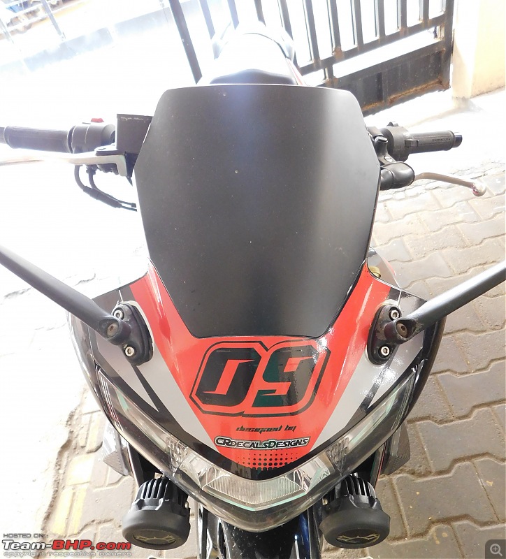

I tried an modification to the handlebar using the Apache split-on based on a previous post in this thread. This was in the plan for a long time and finally got the time to get it done. After the update, the riding posture is very upright and the subsequent improvement in ergonomics is enormous.
I have attached picture of the modification and glad to retain the OEM look.
Honda CBR 250R : Answers to some commonly asked questions-cbr_handlebarpic_02.jpg
Apart from the improvement in comfortability, the major advantage is the addition of space in handlebar for switches. In the stock setup, there is no space to mount switches for aux lights / hazard etc. As the Apache handlebar is long, there is enough space for 2/3 additional switches.
Took a bike for a 50km ride to assess the effectiveness and observed that the handlebar vibrations were significantly lesser than stock. This could be because of the increased weight in apache handlebar, the new rubber grips on handlebar or could even be just a placebo effect. A longer ride should provide a better assessment.
The major compromise is that the windshield needs to be chopped along the sides at the top to allow for the handlebar movement. The chopping is required along the width and the length of the windshield has not changed .
Honda CBR 250R : Answers to some commonly asked questions-cbr_windshieldpic_01.jpg

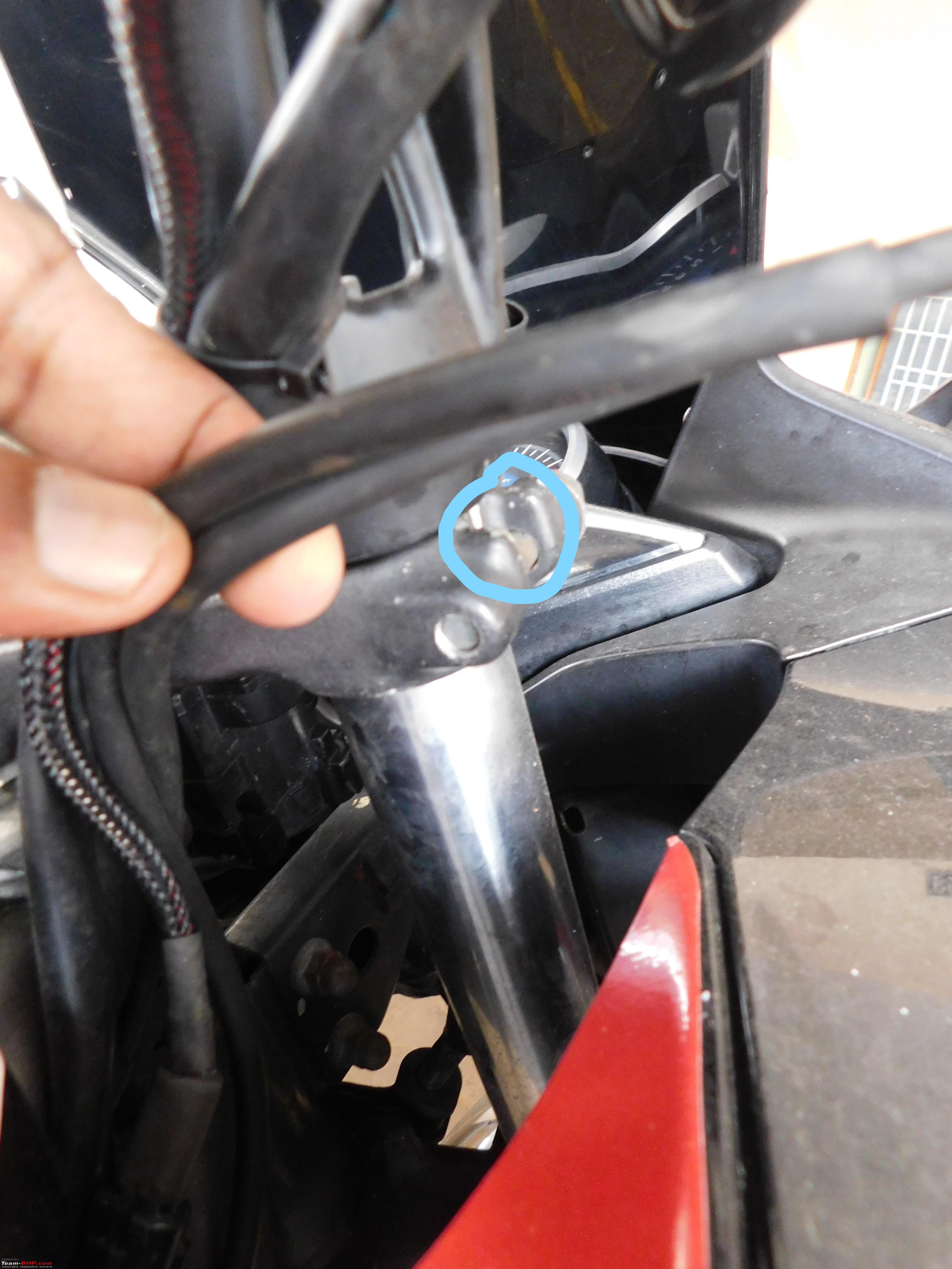

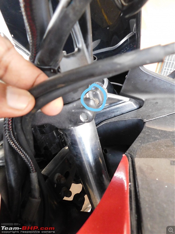

The modification is a not a straightforward swap due to the ingenious design from Honda. In most of the motorcycles, there will be two bolts to fasten the split-on to the forks. One Allen bolt will hold the handlebar along Z direction and the other will arrest the slipping/slipping about the fork axis.
Honda CBR 250R : Answers to some commonly asked questions-cbr_handlebarpic_03.jpg
However, in CBR ,there will be only one and the rotation about fork axis is arrested using a stopper in the casting design. The two lobes acts marked in the image as the stopper in the stock setup. So, we need to drill two additional holes in the handlebar support bracket and the holes position is critical as it aligns correctly the left and right handlebar and got it done in a lathe .
Honda CBR 250R : Answers to some commonly asked questions-cbr_handlebarpic_04a.jpg

1. Apache 200 handle bar ( LH & RH)
2. Karizma ZMR Clutch Cable ==> The stock one can be used but since the Karizma cable was a bit longer , it offers better routing .
This was not a DIY for me and got it done with the help of a mechanic.
