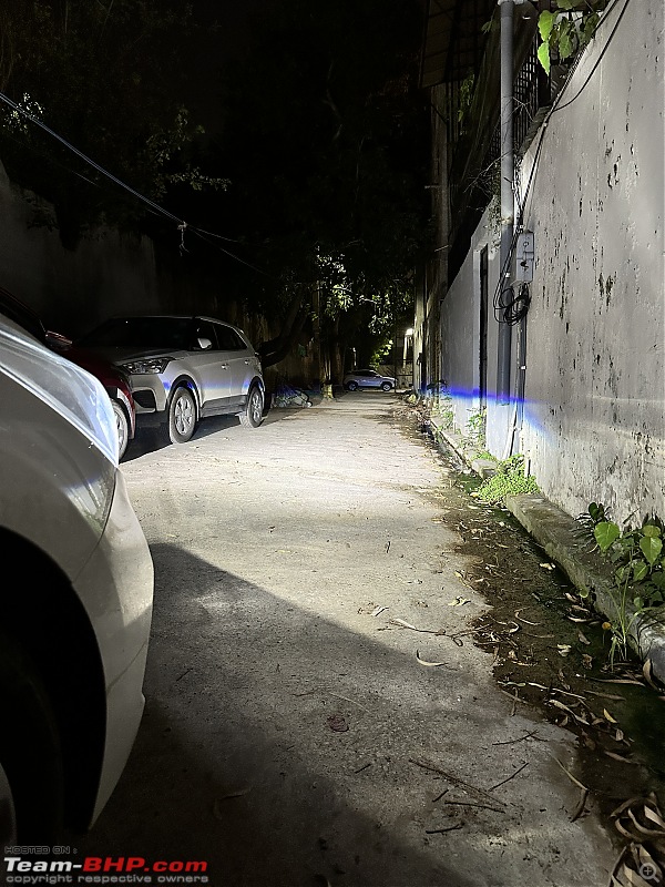

After years of searching for a good LED solution for my halogen setup cars I have finally got hands on a product which looks good and performs even better. I have tried multiple LEDs branded and non-branded (read Chinese) in my cars in search for focused white beams (6000k) in reflector setups but as you already know they mostly scatter light everywhere, even if the road seems lit in white light.
Many times I thought over about going for installation of projectors with HID/LED in stock headlamps but never got enough good reviews of any installer in and around NCR. One could always read Google reviews where users complained of sealing issues, wire tampering, fogging and dust getting inside plus the exorbitant cost charged for installation. And in case the installation goes wrong, the cost of buying a new set of headlights.
While buying iPH from Mr. Amit Sawhney (Contact number 98714 90280) of Blaze India, I got to know about an AES product AES H4 Mini Bi-LED Projector Lens
https://www.aescar.com/aes-h4-mini-b...on_p23367.html
These are by far the best LED solution I have seen till date for halogen headlights, just plug and play solution. 6000k light, focused beam, strong high beam and that blue cut-off for those who desire it.
I got these installed in my Hyundai Verna with halogen based headlamps.
The lights
Auto Lighting thread : Post all queries about automobile lighting here-3364349e0fd148dc8e83ac9a291da888.jpg
Cut-off
Auto Lighting thread : Post all queries about automobile lighting here-img_5945.jpg
Low beam
Auto Lighting thread : Post all queries about automobile lighting here-img_5937.jpg
High beam
Auto Lighting thread : Post all queries about automobile lighting here-img_5939.jpg
