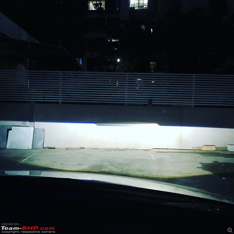

So here is the projector cut off after re-setting it. I basically raised the right beam a bit. With regards to the alignment, I am told that this can be corrected by slightly rotating the bulb.
First pic is before the setting and second pic is after the setting.
Auto Lighting thread : Post all queries about automobile lighting here-projector-beam-before.jpg
Auto Lighting thread : Post all queries about automobile lighting here-projector-beam-after.jpg
The alignment looks slightly better, skewing can be corrected only reopening the headlight assembly and physically realigning the projector.
Since the RHS headlamp cut-off is now clearly visible, looks like it doesn't match the cut-off on the left, cut-off on the left one is perfect.
As harsh79 noted, the cutoff for the right side projector is not perfect. You can also see that the color at the hotspot is not blue as in the left projector.
With this new alignment, one issue is that you will have a dark spot are between the left and right projectors. Your previous alignment where the right side beam is lower and aligned with the lower part of the left beam is the right way to get rid of this dark spot. And that is how OEM projectors are aligned as well.
