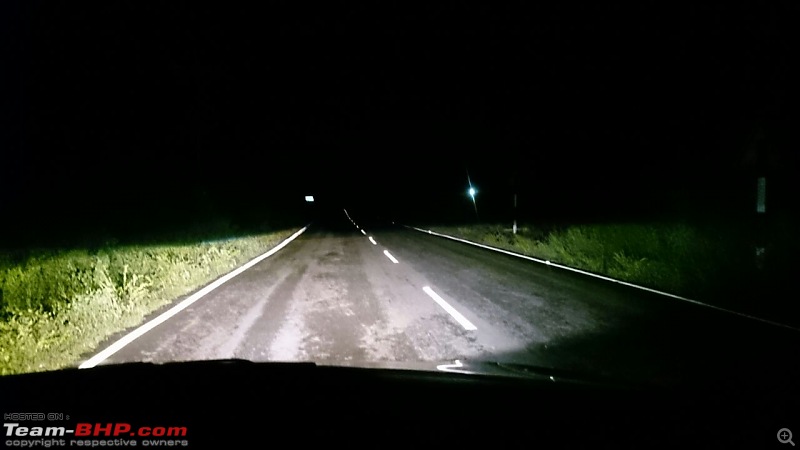

I am using Mini Super V2 projector setup in Baleno from Xenon Planet. I was running with regular 55W ballast. These are not true 55W ballast and start up time is more than 10 seconds. I upgraded to new XP 55W quick start ballast and there is significant difference in brightness and start up time is less than 5 seconds.
Auto Lighting thread : Post all queries about automobile lighting here-img20161008wa0059.jpg
Auto Lighting thread : Post all queries about automobile lighting here-img20161008wa0056.jpg
Auto Lighting thread : Post all queries about automobile lighting here-img20161008wa0057.jpg

@Dr.Naren; Any idea who are they sourcing their ballasts from. I am almost 100% sure that these are being bought, rebadged, and sold. So this bit of Information can be very useful.

Yes, you are right. Xenon Planet doesn't manufacture projector componets. They import good quality products. I do not know the source. It's same with TRS/Morimoto too . They too don't manufacture any products.
