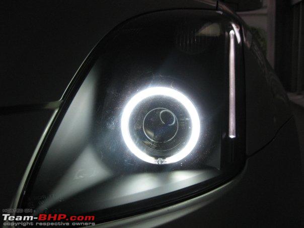

Random question, and I don't know whether it's been answered already (couldn't find it). Cars like BMWs and VWs have these interesting 'light bar' tail lamps, which look to me like LEDs with some sort of diffuser lens. These aren't the better-known multi-LED strands you see (in, say the Alfa Giulietta). Could anyone tell me what these lights are called and how they work? Just curious.
These are just glass tube like filament with a LED bulb at each end. Light flows through them giving that soothing effect. I had a similar setup in my Swift's headlight (the light at the corner and not the halo rings). This had a similar setup but of course a low quality product.

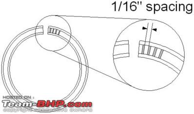

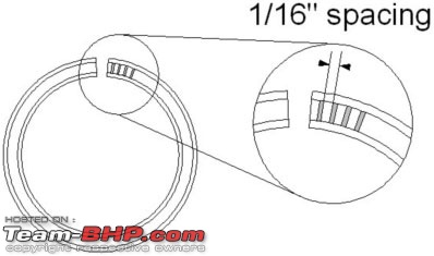

The same tech that works for halo rings works for these tail lamps too. If you take a solid glass or acrylic rod/bar and pass light from either ends, you have light passing through it but the light wont be visible like the ones you see in tail lamps. To make this light visible through out the rod/bar in a uniform way, make fine groves behind the bar and you get the effect of the whole rod lit up. The groves cause light scattering and that's how it works. Make it a ring and you have halo rings, make the rod in various shapes and sizes and you have those stunning tail lamps and parking lights, ambient lighting inside cabin, etc. in various colors depending on the LEDs you choose to light it up. See the pics below to have an idea of how simple it is.
Auto Lighting thread : Post all queries about automobile lighting here-halo-ring.jpg
Auto Lighting thread : Post all queries about automobile lighting here-halo-ring-lit.jpg
Pics source: Google images.
