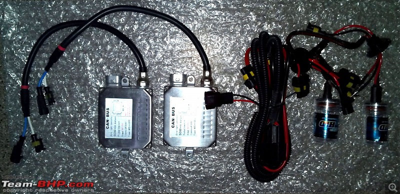

Just got my HID conversion kit for the Civic fogs. 55W, 3000K, H11 with AC Ballasts, complete with loom. I will try and install them over the weekend.
Good one professor. Nice to see that the wiring harness is also included
Please share the costs and where you purchased it from?
I got them from a Kochi based chap who goes by the handle XenonPro on the other forum. At the moment h is business is not active so has asked me to refrain from recommending any more customers. I got it very cheap, much below the market prices. I had asked for the loom. ballasts, and the lamps - 3000K, H11, 35W. He could not get the 35W, 3000K lamps, so has supplied 50W 3000K units with matching ballasts.
