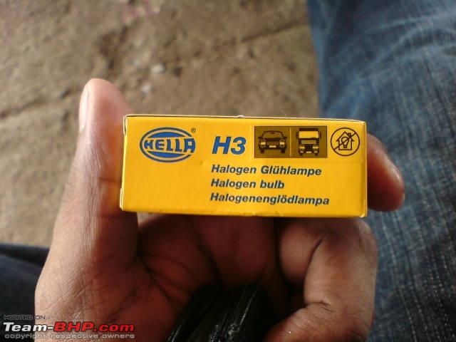

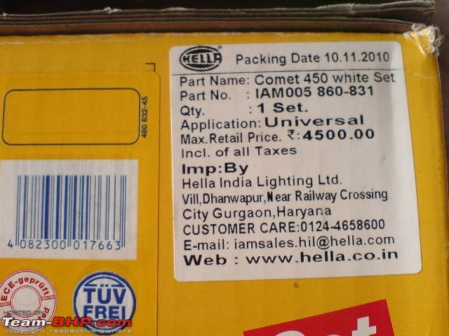

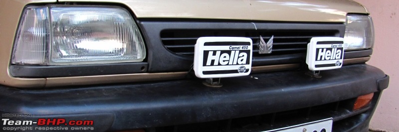

During weekend, I went ahead and got installed Hella Comet 450 lamps on my M800. Initial impression is good, but I'll give thumbs up only if these lamps provide good illumination in the rains .
Here are the pictures:
Auto Lighting thread : Post all queries about automobile lighting here-img_7860.jpg
Auto Lighting thread : Post all queries about automobile lighting here-img_7889.jpg
Auto Lighting thread : Post all queries about automobile lighting here-img_7897.jpg
Auto Lighting thread : Post all queries about automobile lighting here-img_7891.jpg
Auto Lighting thread : Post all queries about automobile lighting here-img_7894.jpg
Auto Lighting thread : Post all queries about automobile lighting here-dsc07302.jpg
Auto Lighting thread : Post all queries about automobile lighting here-dsc07301.jpg
Auto Lighting thread : Post all queries about automobile lighting here-dsc07300.jpg
Auto Lighting thread : Post all queries about automobile lighting here-dsc07303.jpg
Auto Lighting thread : Post all queries about automobile lighting here-dsc07304.jpg
Auto Lighting thread : Post all queries about automobile lighting here-dsc07307.jpg
Auto Lighting thread : Post all queries about automobile lighting here-dsc07308.jpg
An iron strip of 3mm thickness supports the lamps beneath the bumper to provide strength.
The relays conked off in the first usage itself . Got it replaced. And I bought one unit as back up.
There is separate switch for the lamps and they will light up only if the park lights are also switched on. There is also a 30A fuse connected.
Installation was done at AutoMate, near Vytilla.
I'm waiting to drive the car out in rains. I'll update after the drive.
2 questions:
1. Any reason why the relays conked off in the first day? Could it be a faulty unit or heavy load? Can any one provide mathematical figures for calculating the load?
2. Fuse used is 30A. How is this calculated?
Jose.
The relays included in the pack do conk off as they are built to "perfection" Some electricians call it "electronic" relays. Get a roots or PMP relay and they will work fine. (unless of course there is some issue with wiring)
Shubz is offline
Old 13th June 2011, 23:03   #5172
ilangop's Avatar
Posts: 993
Thanked: 928 Times
Thanks,
Jose.
Its basic electrical stuff dude.
Power = Voltage X Current
Curent drawn by one 12V 55W bulb = 55/12 = 4.58 A
Current rating for the fuse = No of bulbs X current per bulb
= 2 X 4.58 = 9.16 A
Allowing a factor of 1.2 to 1.5 times steady state current for initial in rush current, final fuse rating should be 9.16 X 1.2 A or 9.16 X 1.5 A. Approximately a 15A fuse should do the job in your case with 2 X H3 halogen bulbs. As the stock headlamp bulbs are also rated for 55/60 W you could cross check with the fuse ratings of the same. You better go with those values. Say if 20A is mentioned for low beam in your owner's manual, then this should be right value 2 Nos of 55W halogens.
Hope this helped.
