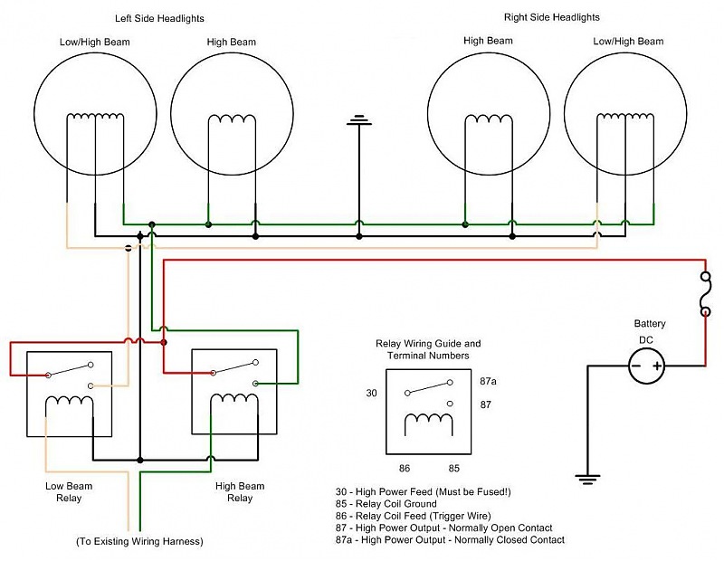

Originally Posted by goandude View Post
Mine is a connected problem (I think).
After a longish highway drive at night when I use the stalk knob to switch off the HL they dont go off.
Happened twice. both times drove 10 -15 meters and repeated the operation of switching off and the stalk knob worked. Sticking relay? BTW Hella relay and harness and 90/100 philips essential vision bulbs.
Looks like you've got 2 relays connected. I faced a similar issue sometime back.
While upgrading from stock HLs, most guys suggest adding a relay WITHOUT checking whether the car has Relays, If there are 2 relays acting, then this problem occurs..
Pl check your electrical circuitry!!
AFAIK no relays are required for stock HL view their lower wattage. relays are added for the 90/100 W. Thus how would 2 relays be connected? My circuit is very similar to the one below. [IMG]file:///tmp/moz-screenshot.jpg[/IMG]
Sir, MOST new gen vehicles come with OE relays for HL even if it is 55/60W.
I HAD the SAME problem in my vehicle and discovered that OE relays were fighting with the newly installed relays. Hence the suggestion!
And relays are good even for lower wattages!!!
Relay is just a heavy duty contact switch depending on the amperage of the contact points. It should not make any mess unless any of the relays have gone sticky/loose contact. If u add one more relay the OE relay will be almost free of load (say 1% load) as its driving the second relay's coils only. Now the bulb load is totally borne by the second relay which is the best at least in case of vehicles under warranty. Every car HL relay is rated to 60W bulb as 55/60 is the commonly used even for 3 wheelers. So if some one is planning to upgrade to a higher rated bulb only go for the extra relays. As long as you are playing within the stock range you are safe with the OE relays.
