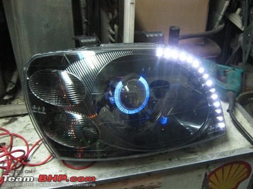

Originally Posted by nitinralli View Post
Again any pics of Scorpio with HID projectors??
Here you go Nithin. Projector HL for Scorpio
Auto Lighting thread : Post all queries about automobile lighting here-200910194842_500.jpg
