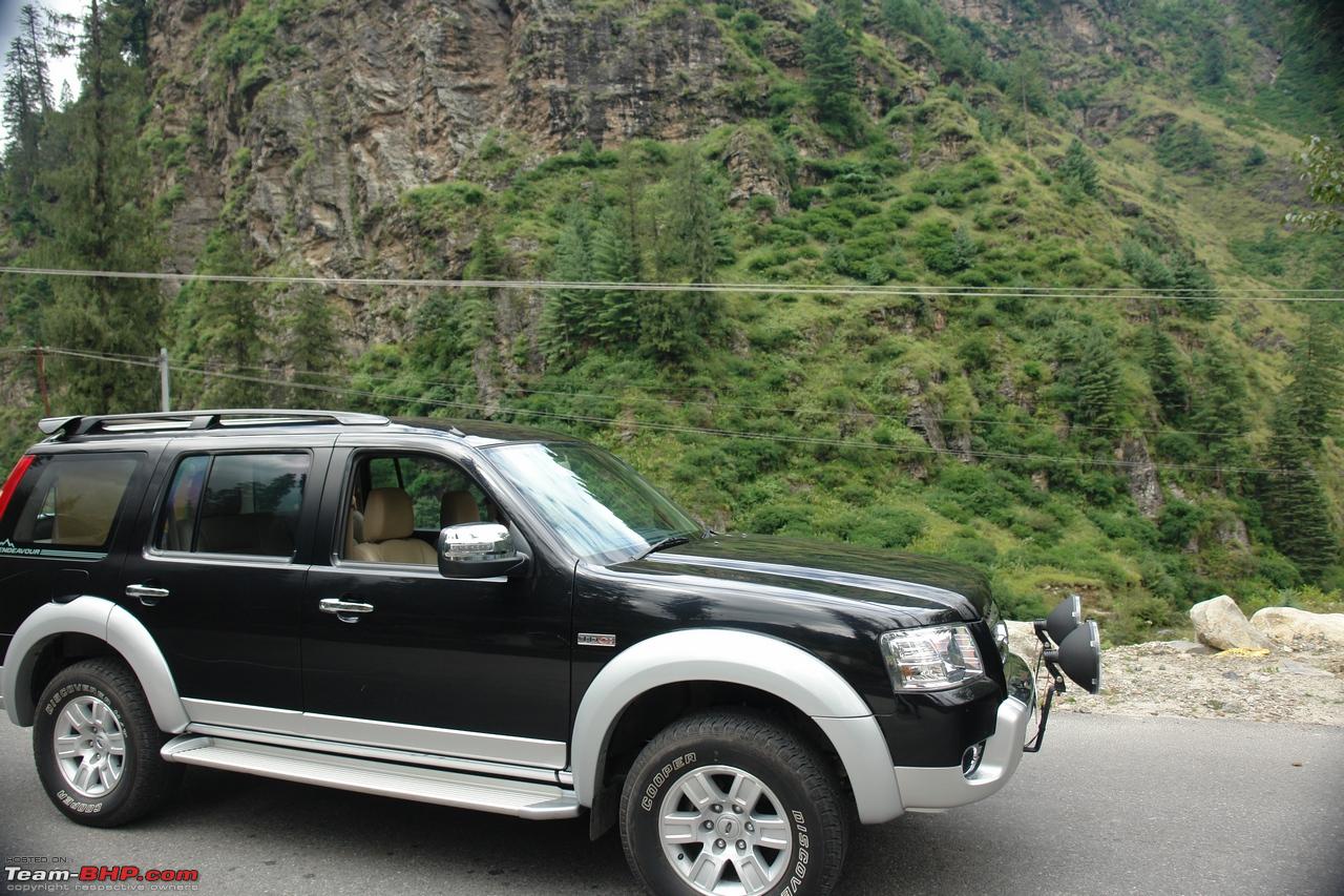

I have lightforce installed on my Endy. I totally agree with Khan bhai on the rabbit story, and also if the lightforce are in action the vehicle in front of you can't stand them and they will try to get rid of you, either by giving way or making there vehicle fast.
Auto Lighting thread : Post all queries about automobile lighting here-dsc03497.jpg
Auto Lighting thread : Post all queries about automobile lighting here-dsc03493.jpg
